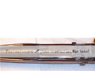

Lets try posting some pics. Looks like he's still got the nosecap, I haven't seen this rifle for many years.
Well, the nosecap is there, that's a very good thing. Getting a middle band is less of a problem.
But, the forend may have been slimmed down, which would make forend restoration a problem. Can't tell from the photo.
The rifle looks to have the small aperture in the rear sight, the earlier pattern bolt stop. Is the nosecap stamped, not milled?
Any markings on the right side of the butt, barrel breech, etc?
Bubba strikes again! Don't want to rain on your parade, but if all the original markings on the right side of the butt are gone, money spent on 'restoration' would not be wisely spent- just appreciate it for what it is now, and if you really want an original, they're still out there, until your gummint decides they want them....sight aperature appears std mil, not early to me. Nosecap appears to be ex. MkII, not MkIII at all. Take it off and radius walnut similar to a commercial R-10, why not?
