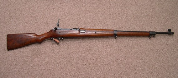

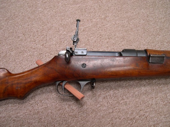

I had a nice Ross Model 1905 target rifle in .303 Brit. Another CGN member has it now. He can attest to it's performance & accuracy... :D
