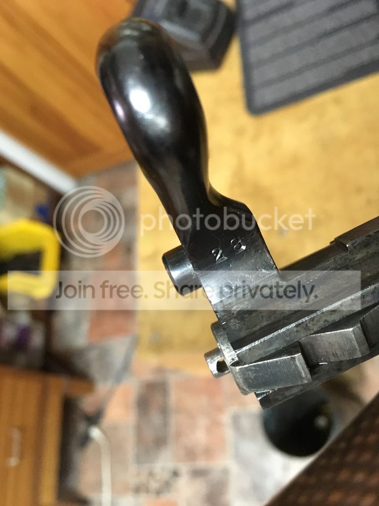

all marking im foud are on pics. ...BUt, have the number 26 on the barrel and on the bolt.

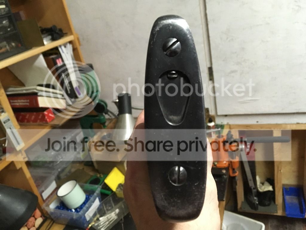

still have the military door on the butt stock, forget to take a pics.

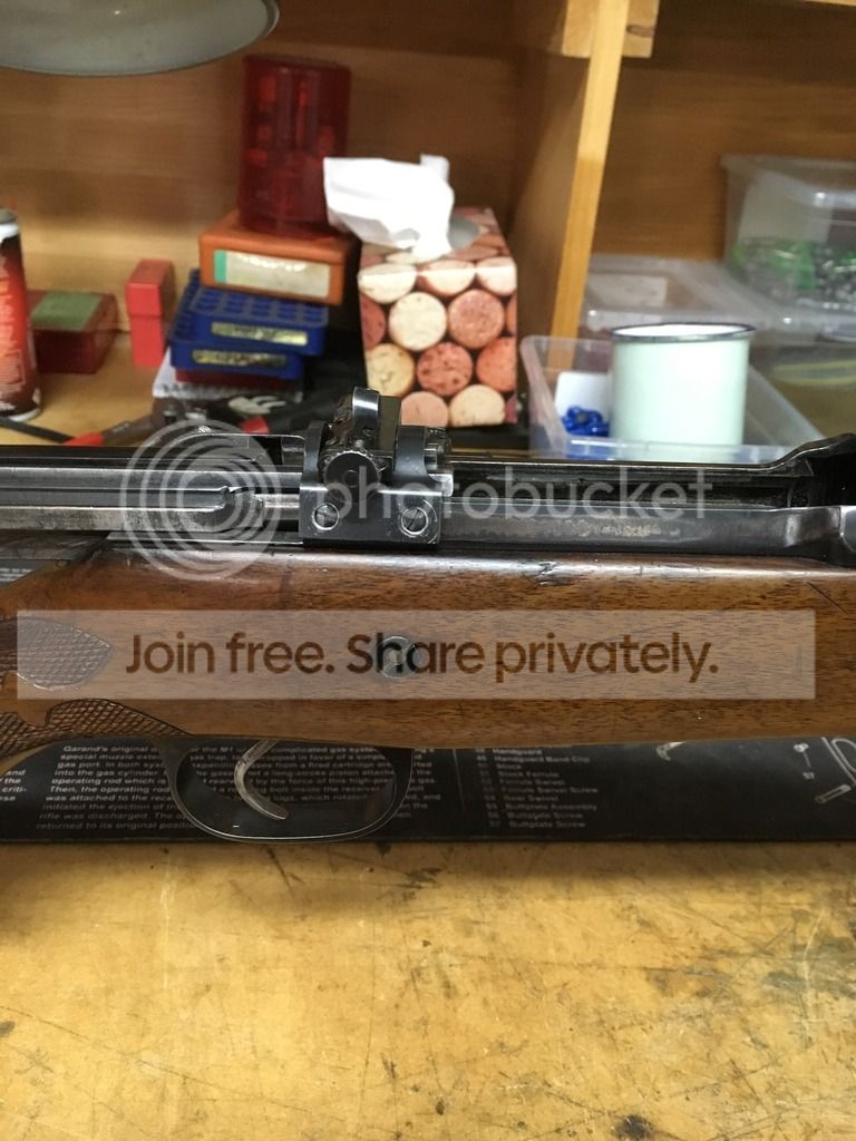

i know about the missing bolt on the rear sight, hole is stippeds.

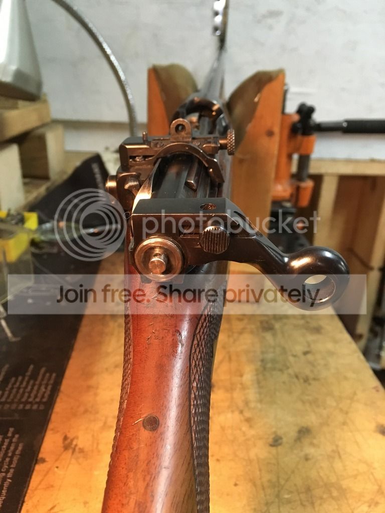

on the last pics you will see the sign of the sight. if you can identificate im will be apreciate. also elevating knob is missing...

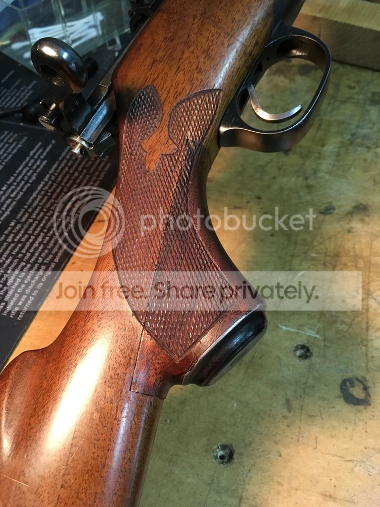

1905 Ross Mark II, originally a Military rifle, Dominion of Canada proof marks, looks like an aftermarket sporter stock but could be modified military stock, Lyman rear peep sight.

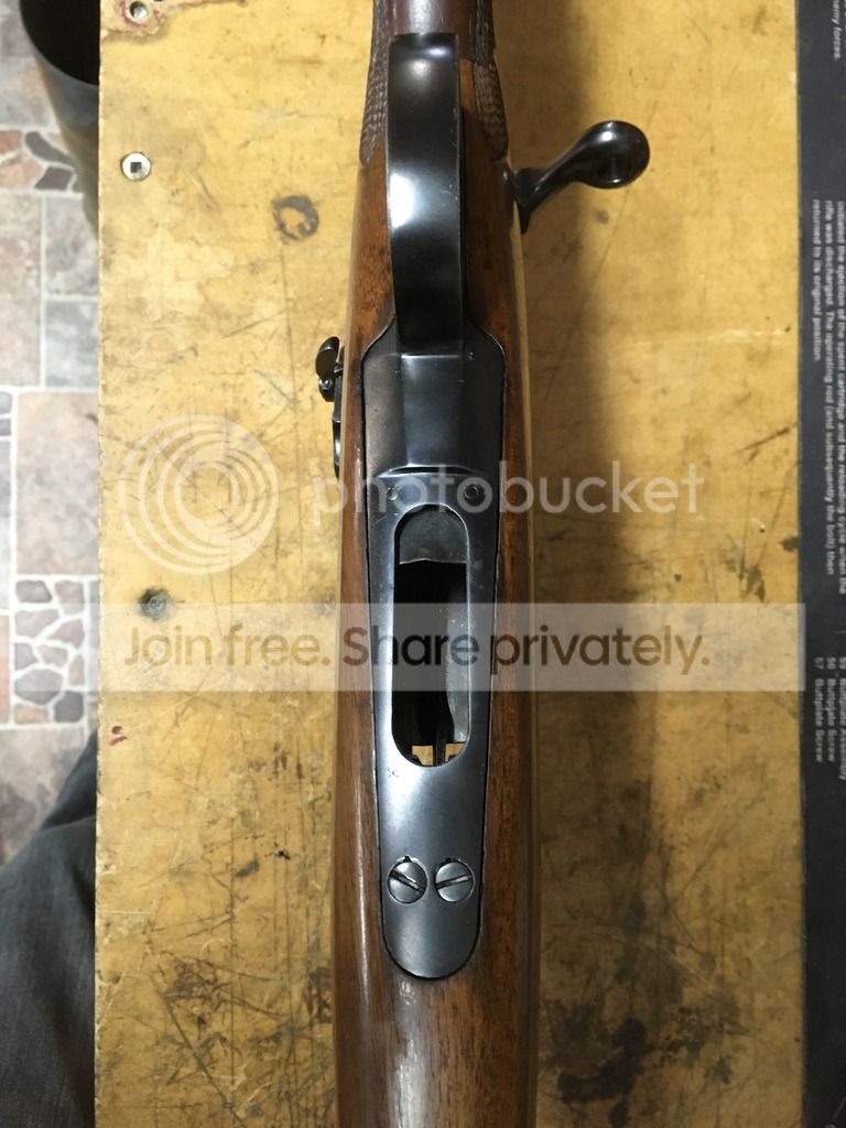

Post a good picture of the safety on the bolt, the right side of the forestock (any wood filler on it?), and the trigger/magazine area under the stock for a better identification.
the front sight is a Redfield.
more pics for you guys. so you can see the number on the bolt, its the serial number ?? foud the same one on the barrel under the stock.
I agree that it is a very nice sporter alteration of the Military stock. The commercial sporters has a serial number about 1/8 inch high, just forward of the front receiver ring on the left side of the barrel. Also, calibre was marked on top of the rear of the barrel, usually "303 Ross". The serial number was probably put on by the Gunsmith who sporterized the rifle.

First, the numbers on the bolt and barrel are inspectors acceptance stamps.
The metal came from (probably) a MKII 3* (guess) and the handle has been cut off the Harris lever (a favour to you as it is not needed and creates a weak spot in the stock where it has to be relived to accommodate).

The Lyman 50 rear sight was specifically designed by them for the factory sporter MKII Ross (and Mausers) and is most often seen on R and E 05s and the odd SDS. (google "Images of Lyman 50 Ross rifle sight") It has no relation to the BSA Martin or any of the other aftermarket sights fitted to military and civilian target rifles. The only commonality is that it is held on by four screws (of different spacing by the way).
The Lyman has unfortunately lost it's vertical adjustment knob (unobtainable) and has some strange screws holding it together so the mice have been at that too.
