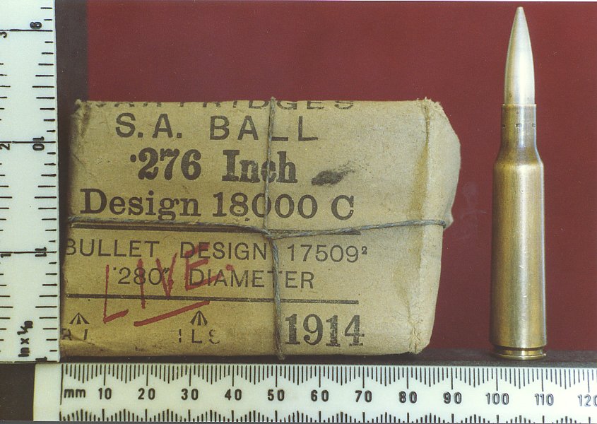

For a Magnum-class cartridge, the Bolt requires NO work; the rim of a .303 is the same size as the rim on a .280 Ross or on a 300 WinMag.
Remember, the rifles were sold, more than a century ago, chambered for the 280 Ross, which had an OPERATING pressure of 68,320 pounds and a Proof pressure of 80,000 or a bit more. The common military action is identical in every way to the action of the 280 Sporters. The Ross Rifle Company did not make military actions and sporting actions: they just made ACTIONS and then used them for whatever rifles they required for the market at that time.
