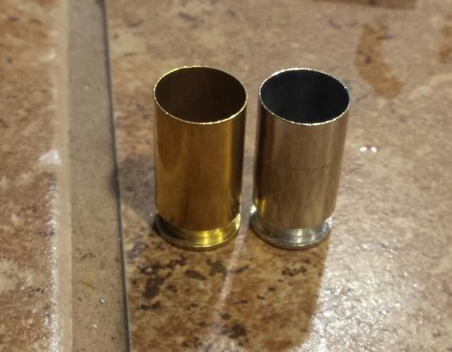

Case penning is a myth. Only downside to wet tumbling is the price of the unit.
There are other brands but they're not any more cost efficient. They cost about as much, and the cheaper ones have less capacity. A FA tumbler can clean 1100 case of 9mm within about 1 hour.
The case on the left was wet tumbled too long and has the "mythical" case mouth peening. This case had been trimmed and had sharp well defined case mouth before tumbling. The case on the right has never been fired and is right out of the factory bag. So even factory tumbling causes case mouth peening.
Case peening is "NOT" a myth and all it takes to see it is a magnifying glass or a camera with a closeup macro lens. This peening can effect both rifle and pistol bullet seating and crimping on pistol cases.
I now weigh the cases before tumbling to not overload the tumbler as it will take longer to get the cases clean, and this adds to the case peening.
Peening the case mouth depends on the speed of the tumbler, the amount of brass in the tumbler and how long the cases tumble. And the peening is caused by the other cases hitting the case mouth. And its not a myth and is a fact of wet tumbling vs dry vibratory tumbling.

Those 2 cases look the same to me. Not sure what you're trying to prove, but reposting the same picture a 100 times won't make a difference.
Penning is still very much a myth. Wet tumbling ftw.
The picture are my cases and are photographic evidence of case mouth peening. I suggest you get a good magnifying glass or new glasses because case mouth peening is "NOT" a myth.
More people below reporting case mouth peening or do you think its a mass hallucination in all the reloading forums. :rolleyes:

Below pistol case mouth peening from wet tumbling.
Bottom line, I have cut my wet tumbling times in half to cut down on the peening. And I'm using a Thumler's Model B High Speed Tumbler, so again the peening depends on your type tumbler, how full its loaded and tumbling times.
