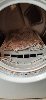

I switched to wet tumbling a few years ago. To dry the brass I use the shoe/sweater rack that came with our LG dryer and put the brass in a laundry bag, and dry it for about 20 minutes, gets pretty friggin hot, enough to evaporate probably 90%.
I leave it on a towel over night to let the insides finish drying. Using the dryer, the air circulates constantly unlike an oven, so it goes quicker.
The pic is to show what I mean, there's no brass in the laundry bag.
