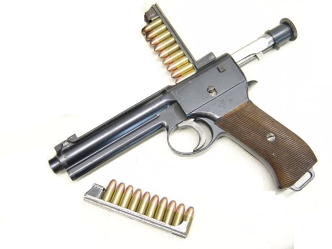

I've always been intrigued by this pistol. Barrel length is 13cm (5.1"), shoots a 8mm Roth-Steyr round. Apparently used by Axis forces during WWI & WWII. Around 99,000 produced.
Anyone in Canada have one? Are they expensive/difficult to find? Anyone have any war photos of soldiers carrying one? I'd love to hear more from the knowledged members here.
I have a 1912 Budapest in tough condition (but still has a good bore and is both complete and matching) Nowhere near as nice as the one in the photo shown. I'm still looking for a stripper clip for it.

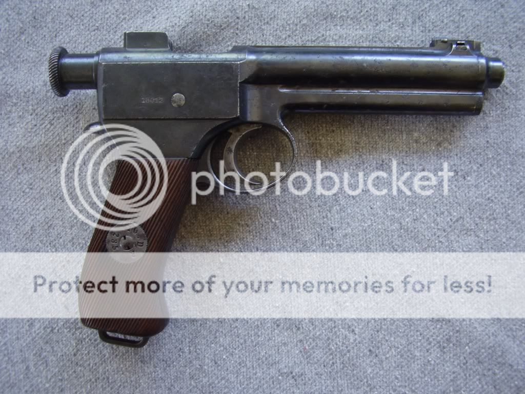

Trigger pull is very heavy and quite long, with a definite break-point just before it lets off: they were for use in a Cavalry charge an they didn't want you to shoot your own horse.
As a Cavalry gun, it is designed to be used in the LEFT hand, same as a Luger.
Cartridge was designed by George Roth, an early specialist in high-intensity ammunition; it is much more powerful than it appears.
Gun was designed by Sylvestr Krnka, the famed Bohemian specialist in torque-locked designs. The gun is only locked (by the torque of the bullet passing down the bore) at the very INSTANT of firing; at all other times there is no locking. Same system was used in the 1911 (or 1912: same gun) Steyr-Hahn and in a very FEW other guns, all the way down to the present VIPER being made by the King Abdullah II Design Bureau as the Jordanian Army Weapons System 9mm pistol.

I've got one and a quantity of Fiocci ammunition from Canada Ammo. No stripper clip either, and after trying it an M1 Carbine doesn't fit at all without major modifications. The ammo fits fine in the clip but the clip is too thick to fit in the guides on the gun. I'm going to try and use a grinder to see if I can take enough material off it to narrow it enough to fit in the guides.
