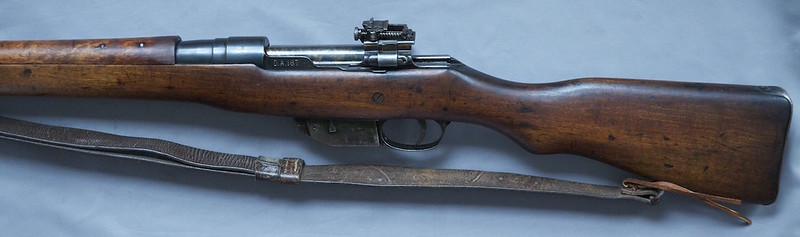

Beautiful rifle. Steve, but you have opened a can of worms with this baby!

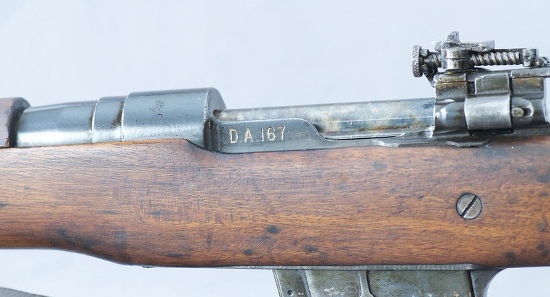

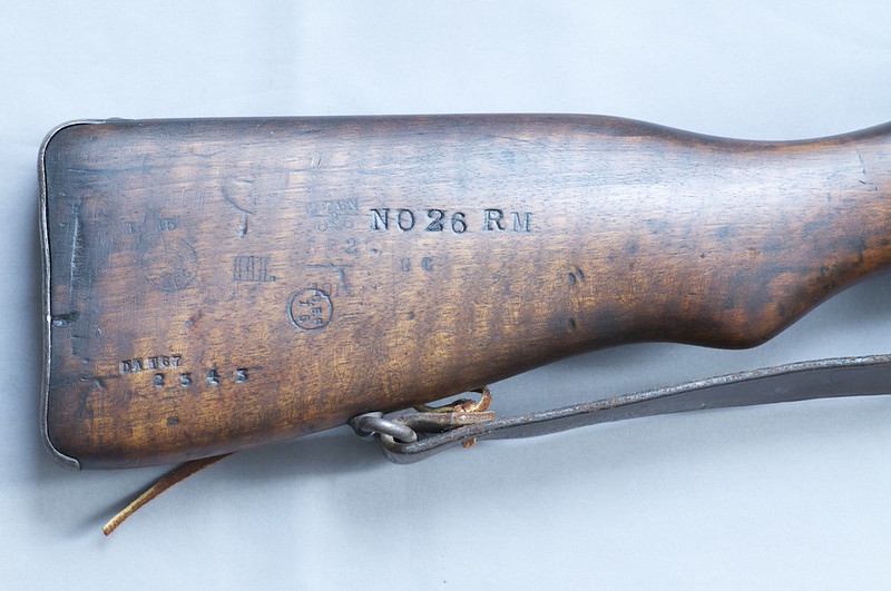

I have DA426, which is also A1625; no other numbers are present: no Company roundel, no standard serial such as you have, no nuthin'. Where did this anomalous A number spring from? Whatever organisation put it there, they had to be big enough to have a need for your rifle, my rifle and at least the thousand between them. This needs research.

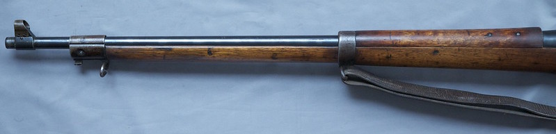

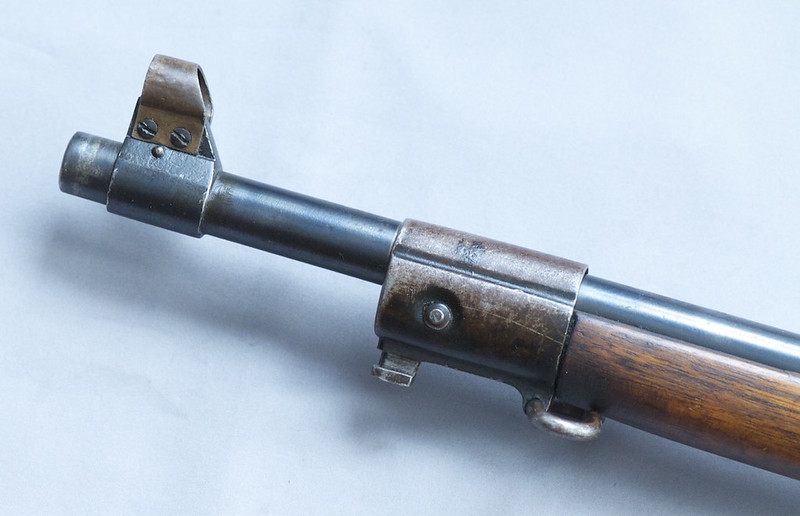

Your front sight protector is on backwards. So is mine and I KNOW that it hasn't been messed with since I got it in 1976. I am wondering if this is common to the Chilean Rosses. Anybody else with a Chileno Ross care to chime in? I know that the sight protector certainly works well enough in this position: two of us with Rosses actually beat a pair of Minimis in open competition and, believe me, the Minimis certainly used a whack more ammunition!
Your rifle is marked to 16 Battalion as well as to 27 Battalion CEF. Mine is marked to 16 CEF only. Interesting point is that 16CEF went to the West Indies first, arriving in Europe just in time to be mauled so badly at Second Ypres and take part in the night attack April 24. Considering losses at Second Ypres, it is entirely likely that your rifle changed hands at that point.

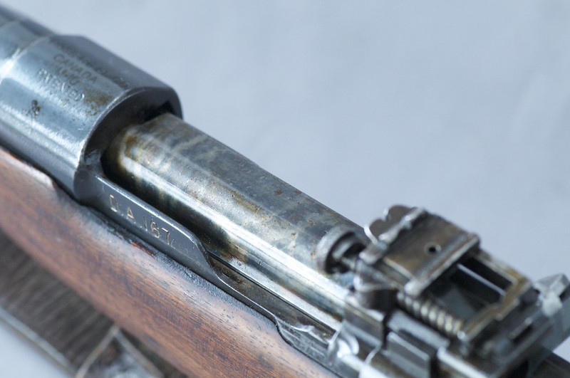

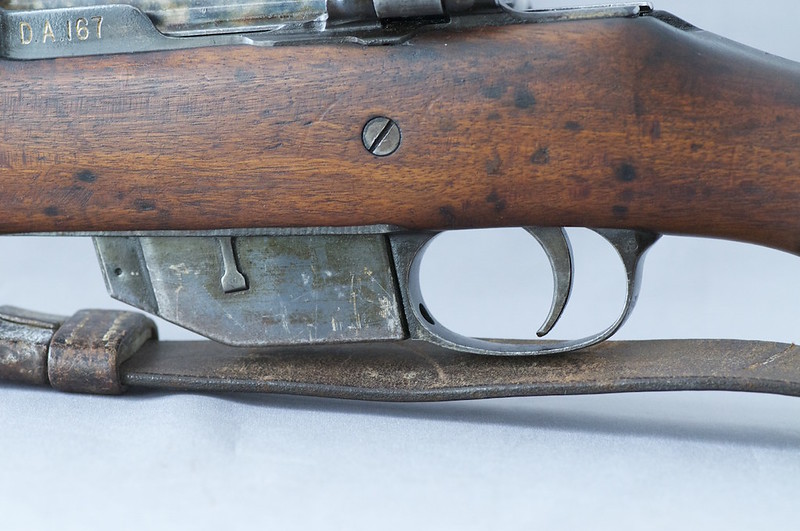

Whatever Ministerio purchased the ship, the Chileans are under the impression that the Departamento de Armada definitely marked the rifles. The DA marking is definitely Chilean, it appears on NO other rifles and it is ENGRAVED: all other markings are stampings, as you can see. Notice also the little DA167 by your anomalous A number on the Butt: it is stamped but it is in a typeface (and thus from a different set of punches) which differs from all other markings on the rifle. It is Chilean, without doubt.

Lovely rifle, great photos!

Thanks for showing!
