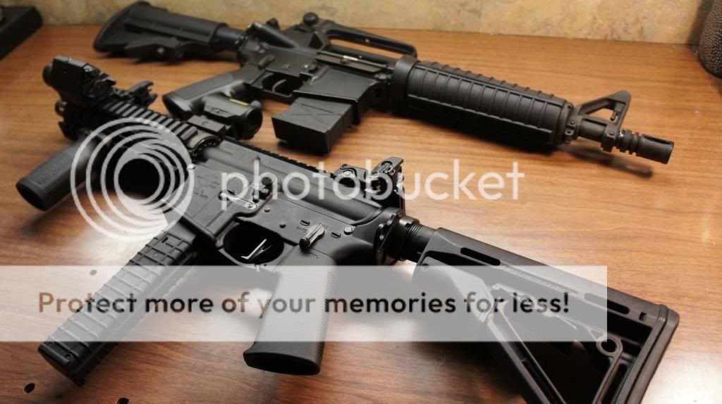

It will work (just the upper) but I'd question how well the gas system would work on such a short barrel.. Also it will be really really short. Likely tough to shoot and shoulder... Also you will make no friends on the range ... But you will look like a badass ... Also you need a huge 4 port break on it ...
If I could make a suggestion. NEA makes a complete rifle in the configuration you are looking for. Why not just buy the entire thing from them.
The RRA shorty hand guard will be VERY short. Notice how the NEA hand guard covers the gas block and part of the muzzle break? Thats because the thing is so short.
FWIW SBR rules are a US thing and have no status in Canada. By "gunsmithing" they mean remove some parts. The NEA CCS stock uses its own bolt carrier and does not have a buffer so it would be pointless buying a RRA pistol and converting it. Just buy the NEA. Did I mention that before?

Truth be told im looking at the RRA pistol mostly for the forend. I know NEA makes a small ar, however the quad rail look isnt quite my cup of tea. Unless i can find a hand guard i like in that size, thats the route i want to go.

What you are gonna discover is that the RRA hand guard is too small. Your fingers will naturally extend over the end and touch the gas block which will get quite hot after a few mags. This is one reason why all the other short barrelled PDW's have a hand guard that extends almost to the muzzle.
The best PDW fore ends I have used are the JP Ent and Midwest Industries 7" rails.
I am in NO way a expert on AR's but I currently own the NEA 7.5" with the CCS stock. This is a great FUN rifle ( hand gun ;) ) The CCS stock uses a proprietary BCG/Buffer all in one and makes this incredible short . In the untouched configuration you get a lifetime warranty - basically peace of mind .
OP it's worth considering the stock set-up from NEA and changing the cosmetic fore guard and parts and wanted. I'm toying with the idea of cerakoteing the finished product in a burnt bronze or something for the ultimate personal custom touch.
Likely be a few $$ cheaper than going with the RRA piece meal and having a typical black AR

Buy the complete RRA pistol and swap out the factory "pistol only" receiver extension for a standard AR receiver extension and drop a stock on it. I had one for a number of years that I did just that to, and it worked great. I did swap out the factory short hand guard for a longer Troy TRX as the factory one is pretty short.
