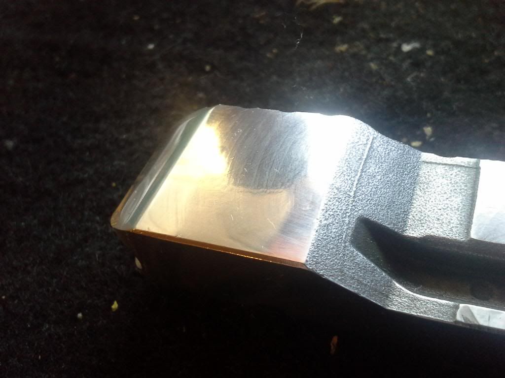

on the top of the bolt

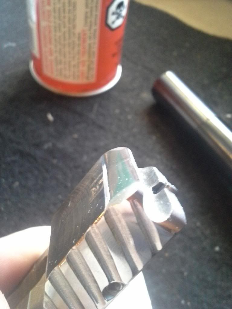

this is the radius or chamfer you heard about
this is easy to do take a 1/8 plate and lay the bolt and flat and mark a line on the top of the plate then do the same on the the bottom so youll have two marks one on the top and one on the bottom an 1/8 from the back.
youll need to polish the radius after you grind it in then polish the flat as well where it rides over the hammer

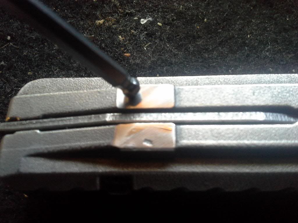

this is the left side of the bolt (opposite of ejection port)
this isn't a high polish its just to even it out and take down the high spots.

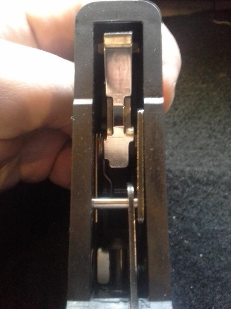

this is the face of the hammer I polished that since the bolt rides over it,my entire trigger group is actually polished I just did it when I did a trigger and for bling factor

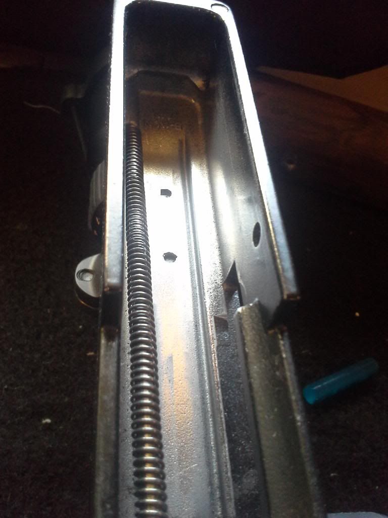

this is the inside of my receiver I polished off the paint where the bolt rides and it made a huge difference I know yours is ss so it shouldn't matter
this is just the stuff I polished up on the action,if your looking at trigger work that's a different story. the best way to polish is to place your sandpaper on a piece of glass and move the bolt over it instead of the sandpaper over the bolt. aside from the right hand side of the bolt (ejection side) you don't want a mirror shine otherwise you might affect function in a negative way you just want to take the high spots out and smooth it out. Grab a jar of mothers mag polish to do the final work on it after you run through your sand paper grits.
The SS ones are still alloy and have a clear coat on them which is like paint. I just feel the bolt will take off receiver material wherever it binds with or without your polishing efforts so an interior polish is a waste and maybe somewhat detrimental but for sure do the polish on the top wear plates in pic one above. Plus the radius/polish of course
Before I polished the way I described my reciever felt like concrete grinding, afterwords it was like butter. Not a waste at all I think. Mine looks just like skoals.
Mine really helped, there was more paint on the inside then the outside its butter smooth now.
