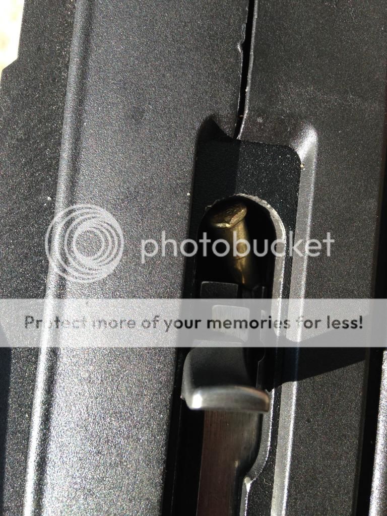

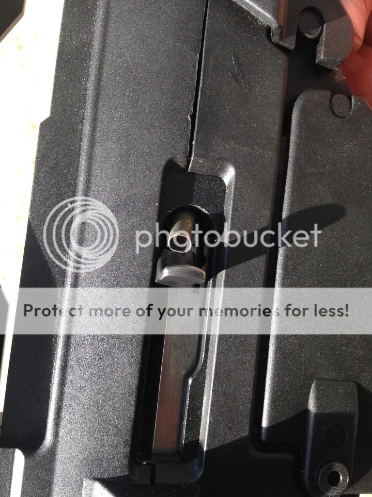

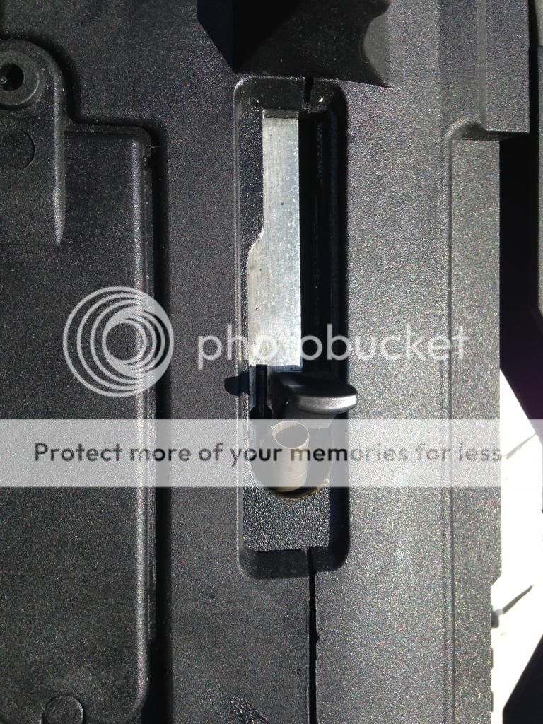

So I got a ruger 10/22 with the archangel G36 stock off the EE earlier in the week. I took it apart cleaned it and lubed it up.
I took it out and every 3 or 4 rounds the brass wasn't ejecting properly and getting caught in the action.
I took the gun home and did another once over and removed some excess grease as it seemed to be probably a bit excessive.
I took the gun back out and I cycled a bit better but it was still happening 2 or 3 times per mag(25rounds).
I have no idea why this is happening
I can add more pictures if it will help just let me know what you want.
Thanks any help is appreciated

I was having that issue, I changed out my extracter FRiday , and it fixed that issue.
Your mainspring may be worn or defective. Order a Wolff Spring kit for your 1022. It will increase your lock time and accuracy. I use Wolff kits on all my firearms... Colt 1911A1, Ruger No.1, Ruger 1022, etc. Very pleased with the results. http://www.gunsprings.com/
http://www.gunsprings.com/Rifles & Shotguns/RUGER/10-22/cID2/mID52/dID225
Also a good thorough cleaning may be in order. Do not over lubricate upon reassembly either! Use good quality gun oil or spray silicon!
I own several Ruger 1022's and I don't ever recall a problem with ammo... it ate everything! (Not the case with other semis which can be picky).
Good Luck and tell us when you figure it out and what it was?

I had the same issue with my Ch22 receiver and hc3r/BC mags. However with the stock mag and the bx25x2 mags the gun is flawless.
I having stovepipe ,ftf, and fte with BC steel lip mags , Then I tryed BC plastic lip mags, worked flawlessly , except for winchester dyna point ammo. Then I changed extracter , even the Win dyna points work at about 95% now. To me , it appears to be , first , mag issues, second,ammo issues, third extracter. That's how it is with my rifle. Using the ruger 10 rnd everything worked perfect. Why not change the extracter anyway , it can't hurt it cost $15 and it's fun to do and easy,:)
Ok thanks for the info guys. I will replace the extractor, and I think I will do the main spring as also mentioned is there any other upgrades that are no brainers that I should do?

Bolt hold open job, though it's not needed, it is much more enjoyable when using your bolt release. It's easy, and free. I used a small file and needle nose pliers,

In my experience both 10/22 s I have owned stovepipe for the first thousand rounds it goes away on e it breaks in.

I have a 10/22 that was made in 1991. Over the last few years it went from
having the occasional stovepipe to a stovepipe every 8 or 10 rounds a real pain in the butt.
I contacted Bits Of Peices in Delta to purchase an extractor.
The person who answered the phone said I should just take the extractor out and sharpen it.
I took the rifle apart and removed the extractor and sharpened it on a fine diamond file.
I put the rifle back together and went to the range with it.
I put over 200 rounds through it and had 2 stovepipes. A big improvement.
