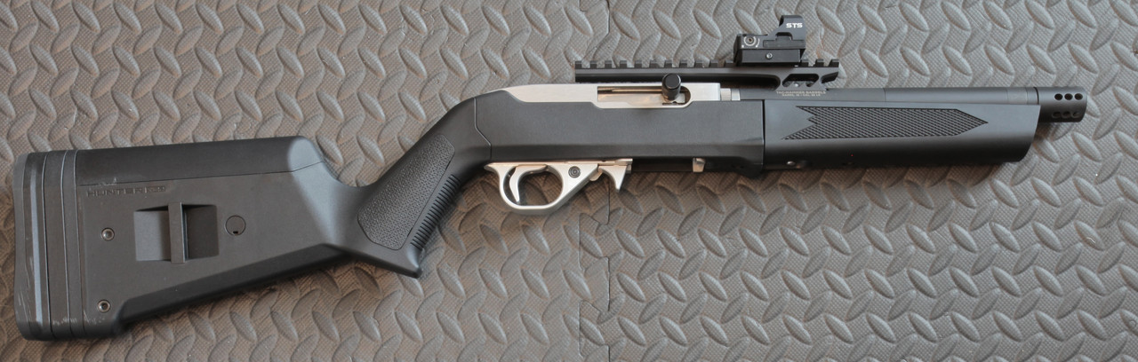

Well, everyone is probably going to give you a different answer. After a dozen years of messing around with various 10/22s and nearly every brand of barrel (including many Dlask barrels) this is what works best for me:
1) Heavy Bench Rifle: Kidd 20" Bull barrel, Kidd 2 stage trigger:
2) Medium Multi-Purpose Rifle: Kidd 10" Bull barrel, Kidd single stage trigger:
3) Ultra Light/Take Down Rifle: Adaptive Tactical 9" TD Barrel, Kidd single stage trigger:
