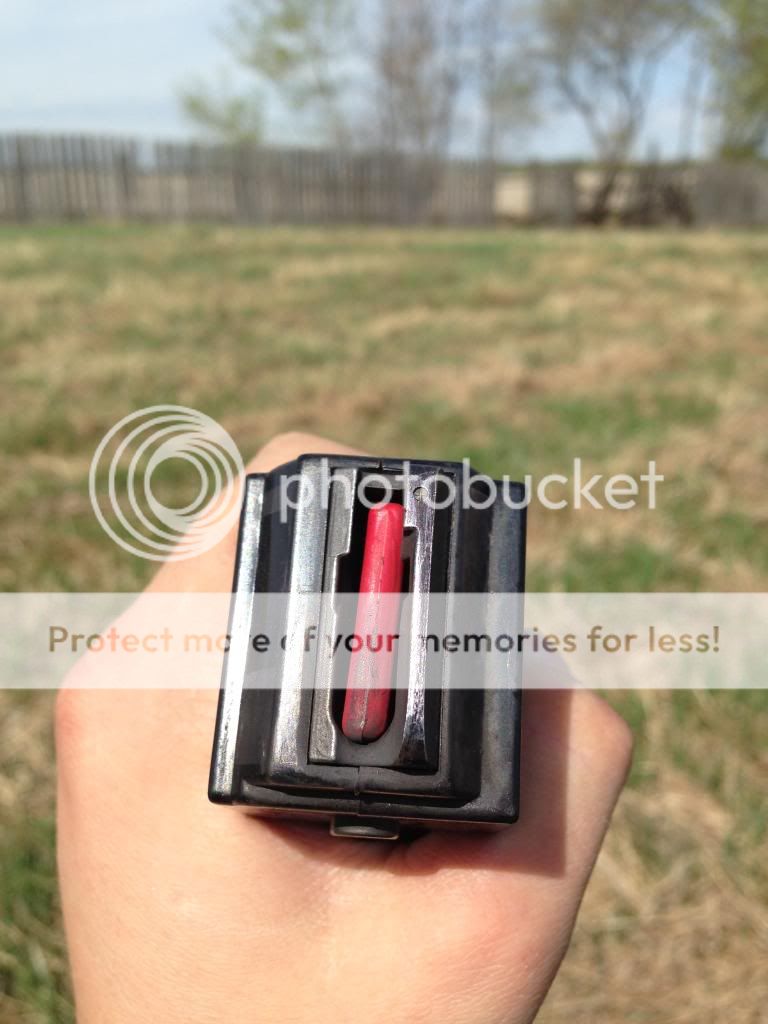

So i recently got my first rifle and made a thread on it. Here is a link to my current build. http://http://www.canadiangunnutz.com/forum/showthread.php/1082195-My-First-Rifle-Build-Ruger-10-22 However after changing my stock to the archangel stock, my butler creek steel lips 25 round mags fail to feed every single time regardless of ammo used.
The mags fit extremely tight in the stock, therefor I had to sand down the inside of the stock just to get them to fit. Even now I can only remove the stock 10 round mag with a pair of pliers. At first I thought the stock was causing problems because I have never had problems feeding this rifle, however the stock 10 round ruger mag works flawlessly with any ammo I have fed it.

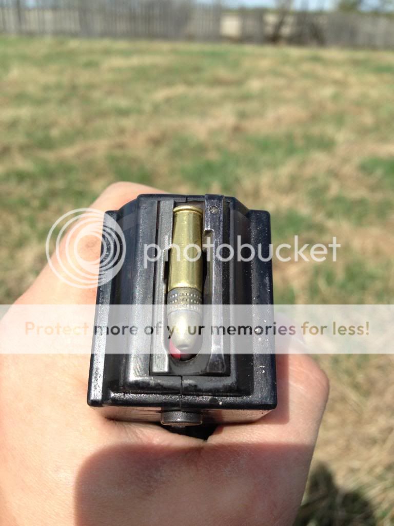

Utilizing the search function on this site, I have found I am not alone in having FTF issues with BC steel lips mags. In an attempt to fix my feeding issues, I filed down the sharp corners of steel lips mags in order to make them more like the stock 10 round ruger mag. This fixed my problem slightly as they now feed flawlessly with around 15 rounds in the mag but still FTF for the first 10 rounds. I then marked the lips on both of my butler creek mags and my ruger 10 round mag with a black sharpie in order to see where the bolt could be rubbing on the mag but all 3 mags (including 10 round ruger mag) had similar marking patterns. I took some pictures of the two butler creek mags.
At this point I am lost for solutions as they fed flawlessly before the stock change but now FTF the first 10 rounds. Should i just keep filing the lips down in the places the bolt rubs? Is the stock too tight and need to be filed down more? Any solutions or input would be appreciated. Thanks.
When I fire the rifle, the bolt doesn't pick up a new round. It perfectly ejects the spent cartridge, then when I pull the trigger the rifle basically dry fires because the bolt isn't picking up and chambering a new cartridge. So technically it isn't "jamming" it just isn't picking up a new round.
the rear of the cartridge doesn't appear to be high enough up to engage the bolt maybe? does it work with other mags? if its JUST this mag, the modify the rear wall of the mag to be lower, or the rear of the feed lips to allow the cartridge rim to protrude higher up. Does the follower go all the way up if the mag is empty or does it have a bit of slop in it? IE the spring not pushing it freely up with some force. Can the round be easily and smoothly stripped off by hand?
If it doesn't work with other mags either, then I suggest its something causing the mags to not go high enough up in the receiver, or the bolt not to grab the round on the way by.
It works flawlessly with the ruger 10 round mag. I just took the receiver apart and gave it all a good cleaning. The butler creek mags now cycle flawlessly for the last 17-18 rounds and fire as fast as I can pull the trigger. But when 25 rounds are loaded into the magazine, the first 7 or 8 rounds all still fail to feed. This leads me to believe it is the mags that are causing me the problems and not the rifle or ammo used. I understand what you mean JR, I think the spring just isn't strong enough to feed effectively when the magazine is right full. Most people say the BC magazines need to be broken but my mags have seen 200ish rounds through them and fed flawlessly if I only put 23 or less rounds in the mag before I changed the stock.
