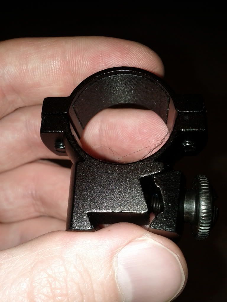

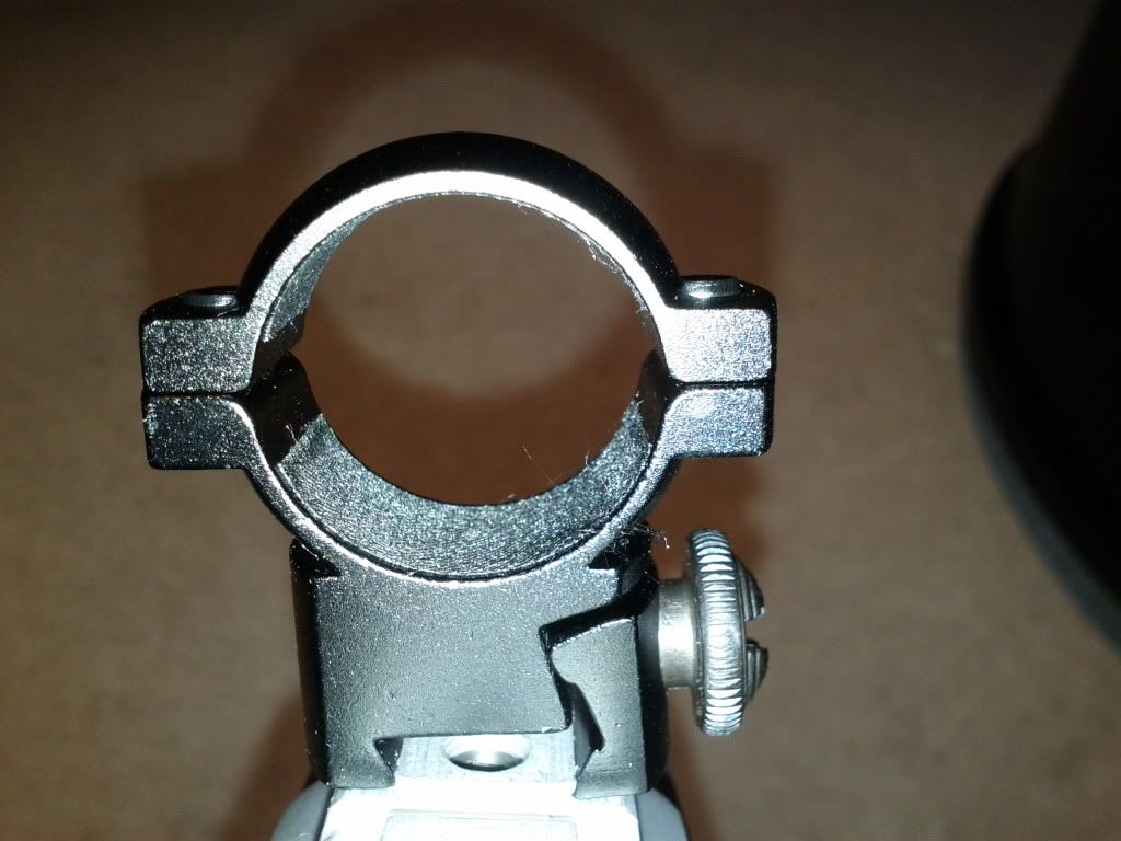

My 10/22 came with the weaver rail as well, but my Simmons scope came with some dovetail rings. Take a look and let me know what you guys think. When mounted, they are skewed.
uhh I don't think that's mounted right. The fingers should be grabbing underneath the rail. You've got then crushing the top portion of the rail.
That was what I thought at first, but the rings are not able to grab the lower part of the rail. Therefore, I need a converter or new rings. Thanks for putting up with a dummy like me :D.
Get new rings!! Adaptivators are not as clean and increase the number of points of failure.
