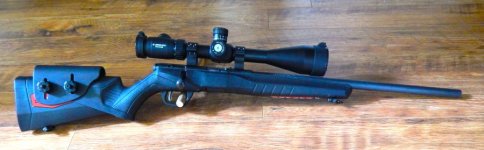

As for the scope, get the best you can afford, within reason.  I have a $700 Athlon 8-34x56 FFP on a $400 Savage B22FV and getting sub-1/2" groups at 50-yds with SK-RM, an 'entry-level' match-practice grade.  I don't shoot matches since there are none within 100 miles of me.  And all NB ranges are closed anyway due to 'fire closures'.

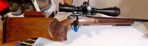

PS - My CZ457 VMTR gets 0.3xx" with the same ammo, just a bit better.  Generally, semi-actions don't get 'super-accurate' results unless you invest a lot in the equipment.
