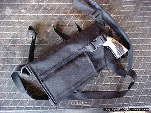

How about these:
http://www.wi####hs.com/knightsrealm/guns/22-45/holster/holster.htm
http://www.wi####hs.com/knightsrealm/guns/22-45/belt/low_slung_gun_belt.htm

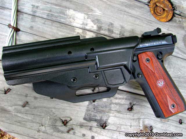

The Kydex holster for a glock 26/27 is rumoured to fit a "standard" Ruger 22/45 (http://ww w.opticsplanet.net/picture-1-uncle-mike-25.html)...
For Uncle Mike's, the "size 5" has been suggested (http://ww w.builderdepot.com/seo/UNCLEMIKES_15/288644_Cordura_Hip_Holster_w_Mag_PouchSize_5.ihtml)
Note to mods: I posted those URL's, in haste, for the pictures. Please delete if you see fit. :D

The Uncle Mikes #5 is a decent fit to the Ruger.
Picked one up the other day and spent an hour with it at the range yesterday.. not bad at all.
Just need to grab a couple mag pouches next.
