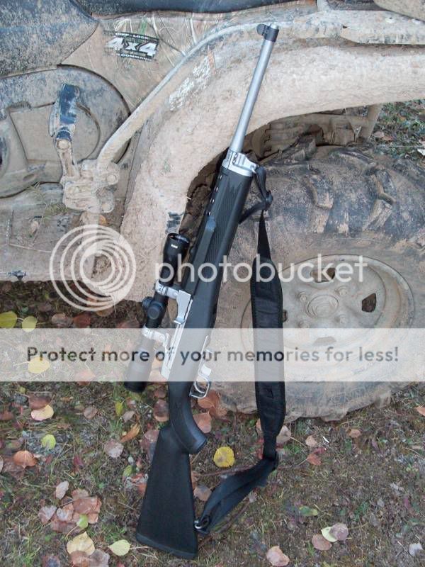

Well, wisely or foolishly I bought a Ruger Mini 14 in 6.8 SPC this August. I love my Mini in .223 but can't really hunt with it. Maybe I should have gone with the 7.62 x 39 but thought it would be fun to try out a brand new cartridge. I wanted something rugged, reliable and quick to shoot for hunting. The mini 14 is all of that.
My first impression was that it was the usual sturdy rifle you come to expect from Ruger. The finish is an unusual semi shiny grey but is supposed to be impervious to water, moisture, etc. The gun functioned very positively and I am yet to have a ftf. I mounted a Bushnell 3200 3 x 9 scope on it. It is a nice compact size for the mini. and has good optics I thought.

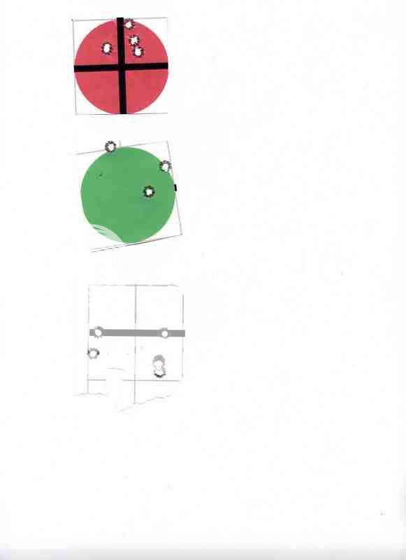

When I first started shooting the wind was quite brisk, probably gusting to 40-45 kph. The groups were quite a bit to the left at 100 yards but the first group was also the first 3 shot group to break the 2 inch barrier. It was 1.5 inches. The next grouping was slightly larger. The third grouping with the highest powder loading was the worst.
Then the wind dropped right off and I fired a three shot group that made me very happy. It measured .600 inches. I fired another 3 shot group with the second increment of powder and while it was good, it wasn’t quite as good as the first loading.

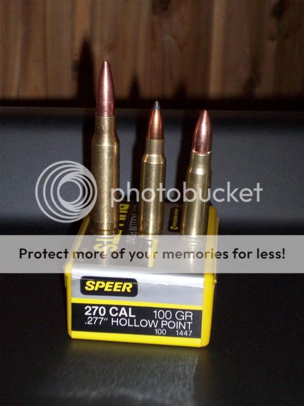

As a side note, there isn’t much factory ammo for this round yet but if you reload, there are lots of bullets to try as they are .270 in diameter. I had no problems finding brass for it and it is listed in Wholesale Sports. There are some shooters on this board who are using the round in bolt action rifles with good success. Because you aren’t constrained by the AR-15 mag COL you can seat the bullet out further and use more powder. It has the potential to be a very accurate round. Whether or not it will be around for a long time remains to be seen. If the American military adopts it, I think it will be.

Bullet comparison: Starting on left- .308; 6.8 SPC; 7.62 x 39
Top group is the best to date. .600 inches @ 100 yds. Hole at 12'oclock is not part of this 3 shot group.
This middle group measured 1.3 inches 3 shots @ 100 yds.
The bottom group is actually two- 3 shot groups shot under windy conditions. The holes at the bottom right are actually 3 holes, not two. Group size(s)= 1.5 inches.
