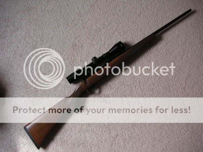

I thought I would share a review of my Ruger 77/22 Hornet. I originally got this same rifle in the late 90s and man did it really suck. I spent countless hours trying to get it to group - everything from freefloating the barrel to shimming the bolt. It would not shoot anything well and I eventually traded it off at a loss. Having heard that recent Rugers were much better quality I thought I would try it again. Call me a sucker but I really like the features that this rifle has, 6 shot flush mag, lightweight 20" blued barrel, and nice blued steel.
The first thing I noticed when I got my new one was that the bolt was not blued like in my original 77/22 hornet. I don't know if the non-bluing was a cost saving measure or if the bolt truly was stainless but it definitely looked sharper. As well, I noticed that Ruger put a proof mark on the barrel to indicate that they produced the barrel themselves, this was also absent on my original Ruger. Here she is below, I took the bolt out because I was cleaning the rifle but the bolt is indeed stainless.

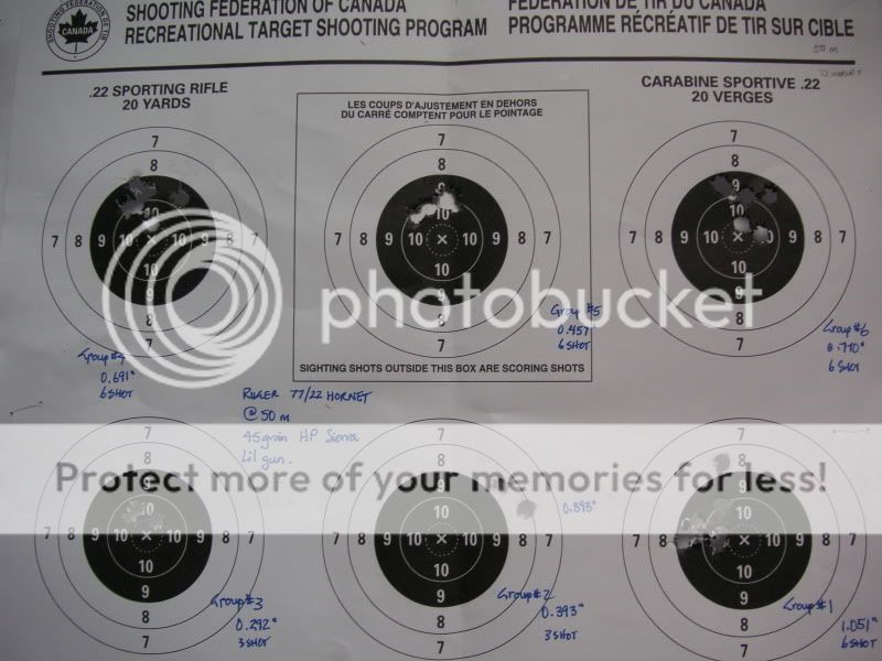

At 50m, I found the rifle grouped very decently. The load was a 45 grain Sierra Hollow Point that was not tuned for this rifle. I wanted to recoup the brass so I decided that I wasn't taking any prisoners on this ammunition. My first group was .393" (3 shots) and about 1" right and .5" high. I decided to leave the elevation but adjust the windage. The second group (3 Shots) was .292" and a little bit high. I then fired a 1.051" group with a full magazine (6 shots). Groups 4,5,6 were fired along the top three targets and were .691", .457", and .770" respectively. I was pleasantly surprised but as this was only 50m not overly impressed.
At 100m, I fired the remaining 26 shots at a sighter target and the overall group was 2.203". After firing this group, I was fairly confident that the rifle was rock solid and that heat was not going to be an issue. When firing I would let the barrel cool after 2 mags (12 rounds) and it was impressive that I could keep all the rounds together.

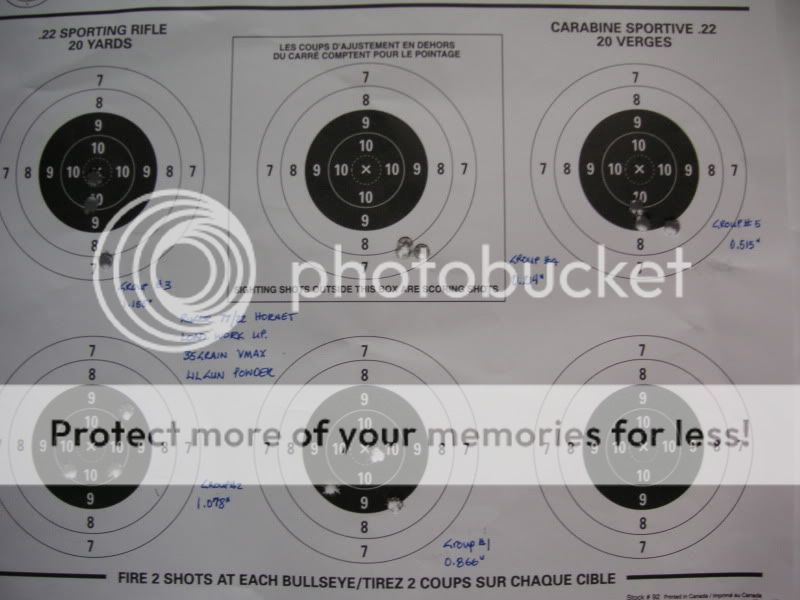

After the remaining Sierra loads were done, I started firing my 35 grain VMax/Lil Gun Loads to see how she would perform. To say that I was amazed was a pretty big understatement. Group 1, 2, and 3 showed no improvement being .866", 1.078" and 1.155" respectively but as soon as the charge hit 13.0 grains the load improved dramatically. with .214" and .515" respectively. I will likely need to do more work as these were only 3 round groups however I am confident that this rifle is a real shooter.
