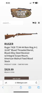

So I just decided to order and import a “new model” Ruger 77/44 the 7428 16.5” bbl (not to be confused with its slightly longer predecessor the 7716 I believe. So guys who own the 77/44 what is your scope on yours? I haven’t rigged up a pistol caliber bolt rifle yet over my years of collecting iron. Secondly what’s your overall thoughts on your 77/44 as far as accuracy and usefulness in hunting. Looking out the gate to do a trigger job with Timney components. Pretty excited to get it when it arrives.

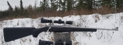

I have had 8 or 9 77/44's over the years, I generally run them with a VX-3 1.5-5 on top, as BUM suggested above. I also used a couple with 3-9's, only because I had the scopes laying around at the time, but in shooting, it was clear that 3X was too much on the bottom and 9X was unnecessary on the top end. However the one I liked the most was a VX-3 1.75-6x32 (pictured below)... it was very bright with a great field of view and I actually used the 6X top end a couple times shooting deer... but it mostly stayed on the lowest setting.20251008_054513.jpg
