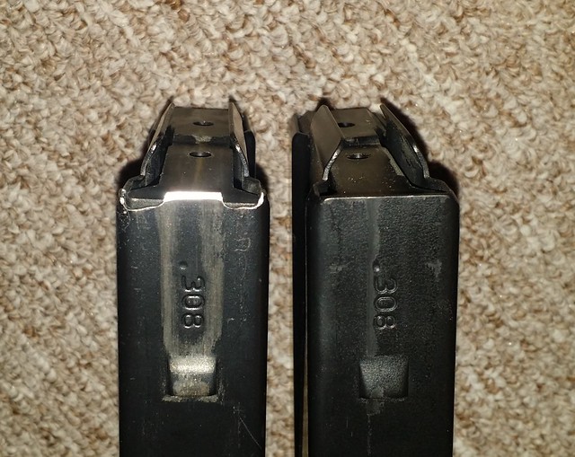

Ok not a true Scout Rifle but this is a 16" barrel 308win Ruger M77 Hawkeye Compact with a Ruger GSR stock and PT&G bottom metal. I love this Compact for carry in the bush during hunting season but I also like the Ruger GSR Scout. I considered getting a GSR but thought that it was a bit clunky for what I wanted, I don't need the forward mounted rail and thicker barrel that does with it. I do like iron sights on my rifles but GSR rear sight has to come off anyway for the scope to be where I want it back on the receiver. Any way managed to get the stock here on CGN, ordered the bottom metal from PT&G (no problem shipping as long as there isn't a mag with it), and got the mag from another CGN member here in Calgary.

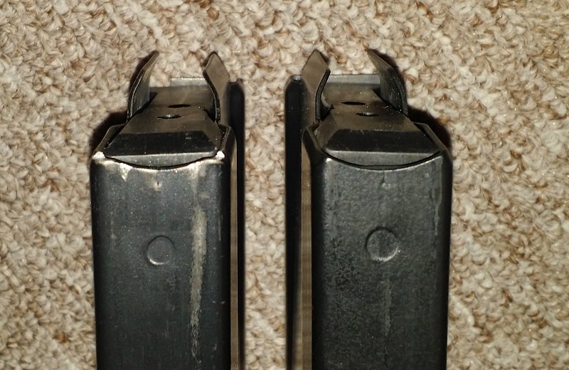

There was a bit of fitting, mostly to the AICS mag but I think I've got it sorted out. I haven't got a GSR to compare it to but I suspect the receiver on the GSR might be a little different than the Hawkeye hence the fitting. There was no way the mag would seat and feed without trimming it a bit at the front and rear corners. It is feeding and ejecting dummy rounds now but I still need to go try it out with some live ammo.

Modification to AICS mag to fit the M77 mk2 Hawkeye when using the GSR stock and PT&G bottom metal...
Front of mag
Rear of mag
