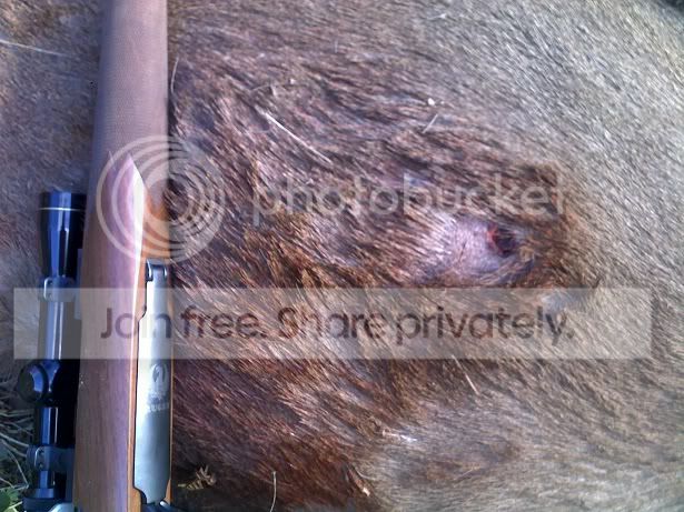

few photos
Nice pics. I don't see why you shouldn't expect moa accuracy. I had a 7600 for years that was very consistent and often 3/4 moa. My load was rp cases, wlp, 59g RL 15, topped with a 250g Speer hot-cor. This is a close to max load, and over max in many manuals. It worked great in my rifle, and brass life was good. It also put nice big holes right thru elk. Recoil was stout, but not terrible.
It maybe to hot for your rifle, and temperatures. If you try it work up to it, on a hot summer day we saw 2620fps on the chrony, but usually more like 2520-2550. I too went to the 300 wsm, and have been very impressed with the rifle/cartridge.
Excelent choice for do it all hunting rifle. The 35 Whelen excels on large game with quality 250gr bullets and RL15 powder (same as Norma203). Yes, handloaded Rugers should shoot well under 1.5 moa.
