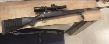

Is your rifle Blued? Most of the synthetic stocked rifles in .350 RM were stainless, unless someone restocked yours with a factory synthetic. For a laminate stock, you can order directly from Boyd's or if you want a factory synthetic, contact Gravel Agency (Canadian Ruger warranty center) in Quebec. I am pretty certain that they can no longer get factory Grey SA laminate stocks, but it is worth a shot. They will want the serial number of your rifle. Boyd's is your easiest route.
Yes it’s blued I’ll attach a picture.
You aren't the original owner? As far as I know the only Blued Mark II 350's sold in synthetic stocks, were in the Zytel boat paddle design... it is likely that someone swapped the walnut stock out for the factory synthetic... some of the walnut stocks on the blued. 350's had pretty amazing grain... I had a couple of those, and it did make you think twice about beating it up in the bush... the easy fix to that was swapping the walnut for the plastic... I suspect that happened to yours.
Well it’s a bit of storey how I ended up with this rifle. I used a 45/70 as a for years as a guide/river rifle. My best friend was adamant about me getting a .350 RM, eventually he just gave me this one. He told me to use it before I pay him for it. It came in its original box so I thought? It was brand new never fired. So learning that came in a walnut stock is all news to me.

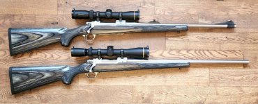

I'm driving home from the range... I got my .350 RM Carbine sighted in for an African hunt... this is with the Leupold VX-R 2-7X33 mounted. I was going to work on the 6.5 RM as well, but forgot a 0.050" Allen Key for the Leupold Turret... that will be another trip.
Oh how I would love to get my hands on 250 partitions. How do you like that Leupold? I bought that 1-8 strike eagle. It’s worthless after 6 power. I’ve been thinking about some new glass.
I like the VX-R's but they aren't making them anymore. I have several VX-3HD and VX-5HD scopes with IR, and they are decent. I like the VX-3HD 1.5-5X20 IR on my .458 WM Carbine... very bright and fast target acquisition.
Some 'polymer' stocks are cheap, others not so much
I put a B&C on a Ruger and was happy happy
any identifying labels on your stock? On the butt maybe?
His stock.is the standard Ruger factory synthetic... in other words, plastic.
You can foam fill the buttstock and epoxy in a carbon arrow shaft into the forend to stiffen it, but an aftermarket laminate is cheap and a better way to go.
