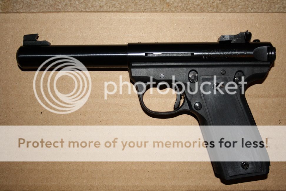

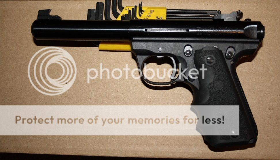

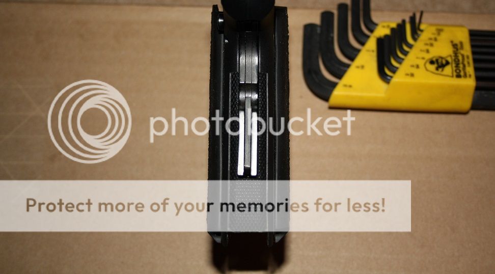

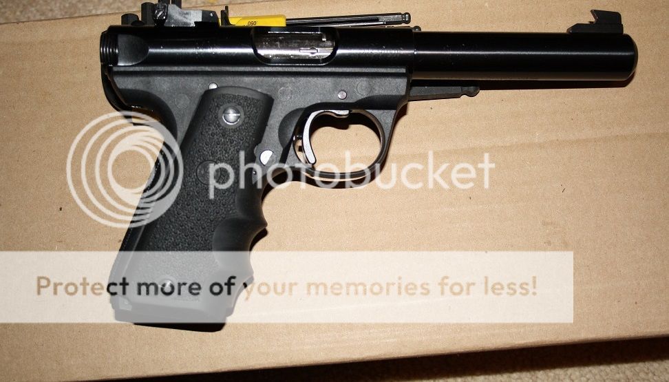

So I finally finished this project, to recap I installed: Volquartsen Trigger, Hammer Bushing and Target Sear. I also sanded down the grip panels drilled four hole and filled them with 1911 grip bushings and then installed Hogue 1911 grips. The grips are unreal, it was like they were custom made for my hand. The feel of this pistol now is amazing, I am shocked at how good it feels. This was my first real project so its a little rough around the edges but for me its all about how it feels in hand. Not to mention the amazing trigger pull with no creep and its super crisp @ around 3-3.5lbs.
Total cost of parts from Brownells: $155 CDN ( I got hit for $25 upon delivery and the exchange rate is $#!+)
Here are some pics.
Grip Bushings
I cut the grips a bit too much to make way for the bolt release and ended exposing the line of the old grip :bangHead:
Really nice work Hawkeye80. Are the grip bushing just threaded into the plastic frame or did you use something to glue them in more permanently?
Looks ace man!
Nice job.
Thank you sir, took quite a while to do but it was well worth it.
I used a bit of super glue to help secure it but I'm not sure how well it will work on the metal bushings. I plan on keeping these grips on permanently so if I need to use JB weld or something else later down the road remains to be seen. Hopefully it holds up though!
