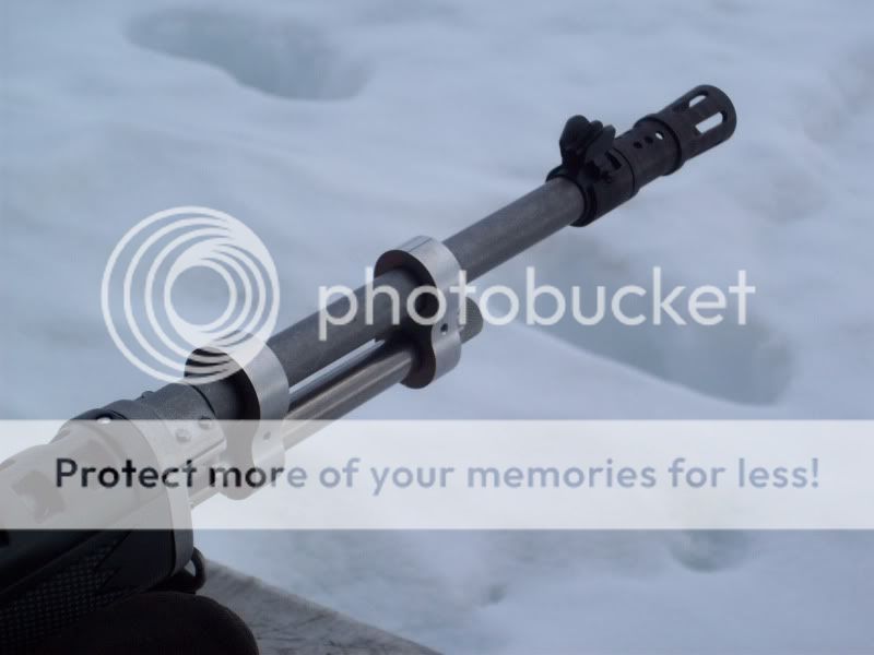

Research showed that a muzzle brake was one of the most effective ways to improve accuracy. I ordered a muzzle brake from Ellwood Epps as they had the one I was looking for and they were on sale-bonus. Not the most expensive upgrade out there but it was recommended over at Perfect Union so I figured I had nothing to lose if it didn't work out. At the very least it has a certain "cool factor" but I was hoping for more than that. As with many upgrades there was an install issue. You have to replace the roll pin that holds the front sight in place with a longer one that holds the muzzle brake on as well. The pin that came with the kit wasn't a roll pin and it was only .117" in diameter. The shorter factory roll pin is .125". I got a proper sized one at the hardware store, cut it to length with a dremel tool and it fits perfectly (although not blued- small point but annoying to me.)

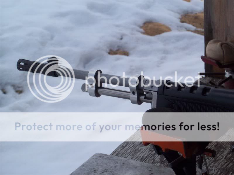

Secondly I installed a Mo Rod, again after some research. Most reviews of "barrel stiffeners" are pretty subjective. They don't really show you practical results- just testimonies which are usually meaningless. At least his website has some before and after pictures. I don't understand why most guys shoot groups with minis at 50 yds. Shoot them at 100 like any other rifle. It too had it's install issues. It comes with no instructions. I know it should be a straightforward install but wasn't. I used blue loc-tite on the two hex screws that hold it in place on the gas block. They kept backing out and the Mo Rod would move forward about half an inch and change the POI. In the photographs on their website the Mo Rod is installed right up close to the gas block but I couldn't get mine to fit there. The inside of the clamps are tapered to fit various series. Mine was the right series for the kit but doesn't fit exactly where they put theirs. The taper wouldn't allow it to go any further up the barrel. Don't know if that is important or not.

OK, so how did this all work out? Was it worth it? Well the muzzle brake definitely makes a difference. Louder of course but that's ok. More importantly it does work. I was shooting at some clay birds at 100 m and could see my hits. Does the Mo Rod work? Well the groups are better. Not as much as they claim but better. I don't get these weird flyers anymore that always popped up. I can shoot longer and still maintain accuracy without waiting for the barrel to cool down. You can feel the heat in the Mo Rod after ten shots and it definitely dissipates better (faster). It was annoying having the stabilizer move around but I think that problem is fixed.

Muzzle brake installed
Mo Rod close up
Mo Rod close up
