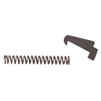

Browsing the CGN forums, I found some threads on the MkIII and gave them a read. Someone suggested removing the LCI (loaded chamber indicator), as that was known for causing issues for loading/extracting. So, I decided to give it a shot. Last night i got my trusty telescoping magnet out and removed the LCI, as well as gave the moving parts a little oil for good measure. I put 280 rounds through the little bugger this morning (mix of all manufacturers) and only had 3 failures, 2 of which seem like bad rounds(large strike on the primer, but no ignition) and 1 stove pipe. It would appear my issues are no more!
