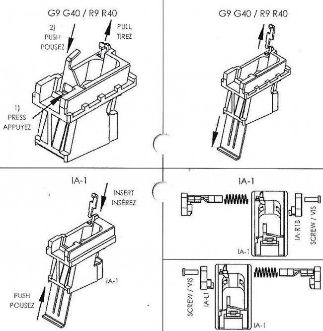

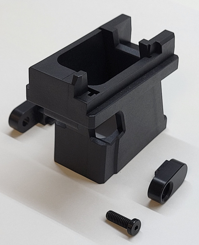

I had to make a groove in the right hand side mag button (I flipped the buttons opposite of what's in the vid above) for the tandemkross extended mag release lever to ride in. Took me 5 min. Works great (remember to blue locktite your reciever lugs and the mag release hex screw)
Looking at my rifle I think I know what you are talking about - you had to make groove on the rear of the RH mag release that comes with this insert kit for the Y shaped arm of the Tandemkross Extended Mag release lever to fit into....
This pic is the RH release button that comes with the Tandemkross chassis
So you can't just use the RH release button that comes with the Tandemkross chassis? Bit of a bummer but good to know a slight mod makes it work.
I have a Tandemkross LH large release button as well, guess I can't use that with this kit, or can I?
