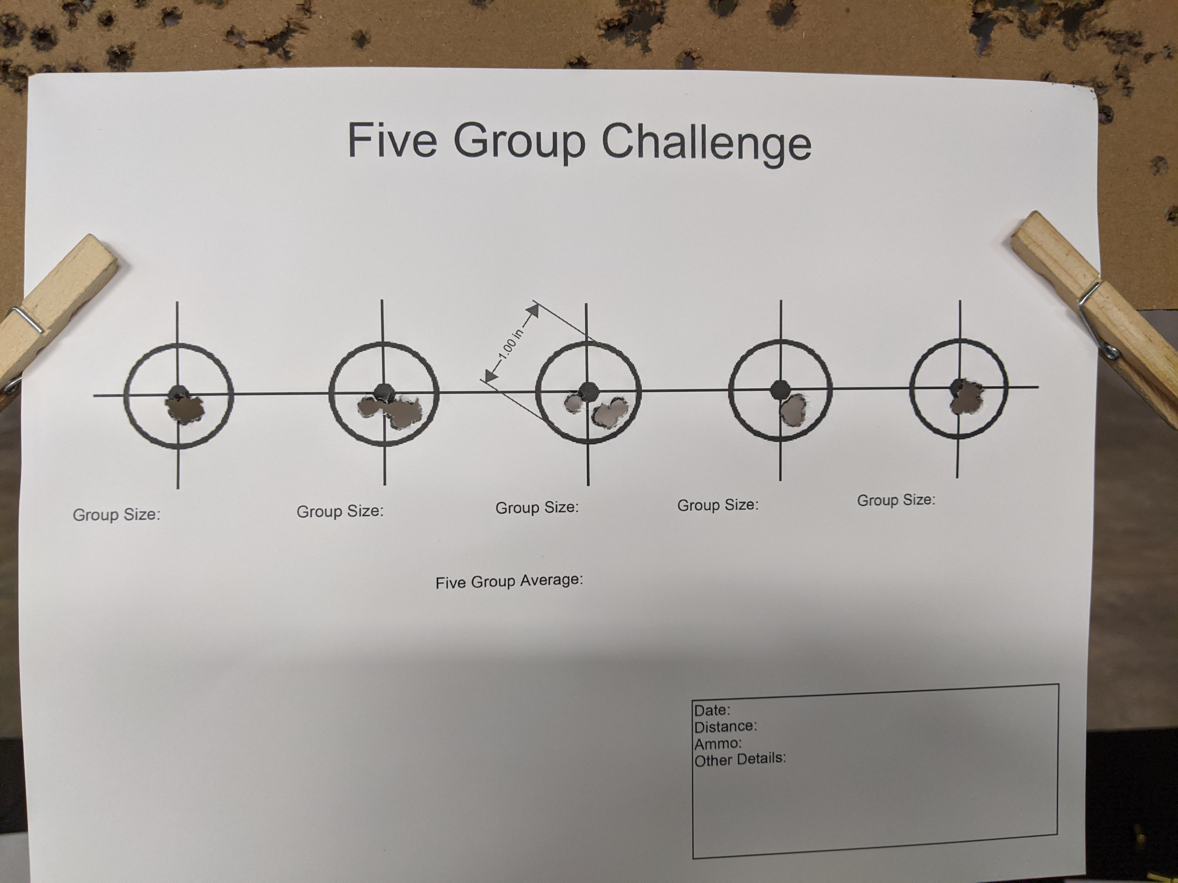

Best Results
My best 5x5 average is here – Casual OnTarget measurement says it was an average 0.226” (0.200”, 0.332”, 0.121”, 0.248”, 0.229”). This is what Glenn would call the wallet groups. Shot with Lapua CX.
I keep a detailed log of my shooting results. This isn’t some review where someone shot 5 groups of 5-shots with different types of ammo. I’ve put 8,245 rounds through and I can tell you definitively what this rifle is capable of. For the last month, my average group size at 50 yards has been somewhere between 0.289” to 0.360” depending on the ammo type. That should be about 0.552-0.687 MOA. That’s not to say my rifle is sub-MOA all the time. In the 186 groups shot, 7 of them (3.8%) were above MOA due to a variety of reasons.
For those who say that 5x5 isn't good enough, here are a few more examples of recent shooting:
