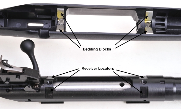

We typically bed new bolt rifles. If bedded, is the Howa and Ruger equally accurate? We load 75 &77 gr bullets and shoot mostly at 300 yds.
The Ruger has two steel V-blocks in the action that mate up with slots machined into the receiver for them. Fit has seemed good enough I never bothered bedding, tbh. My 7.62x39 and 6.5 Creed were both sub MOA without it and never wanted to experiment.
If the STANAG magazine is what you want to roll with, the RAR is your huckleberry and it's only competition (the MVP) doesn't compare at all when we are talking smooth operation.
No need to bed the Ruger, when you have one in hand and remove the stock from the action you will see the dual recoil/pillar arrangement and it is actually a great design.
You'll definitely want to bed the Howa, but the biggest issue to get around is the plastic bottom metal and not being able to put any measurable torque on the two action bolts without breaking/crushing the polymer.
With the hogue stock you can torque the polymer legacy magwell to they’re recommended values, it gets interesting when you install it in a stock that requires higher factory torque values. I’ve got around it buy drilling out the action screw holes and deepening the hole depth to accommodate tapered stainless pillars, if you get the profiles correct in the holes and the pillars the exact length they take all the force and the plastic trigger guard/mag well is snuggly held in the stock inlet. I was able to torque a set to 65 in/lbs without crushing or breaking it and use the factory length action screws, there’s just enough thickness on the rear action screw hole of the polymer trigger guard to accommodate the pillar and get full thread engagement of the screw into the action. Plus it’s way cheaper to buy a legacy mag kit and multiple mags than any of the metal conversion kits, yes they’re cheap but they work well.
