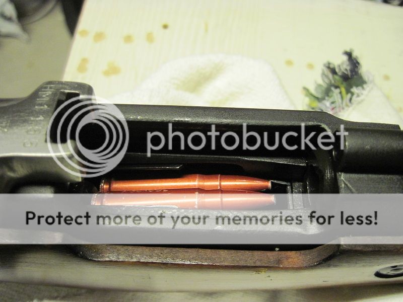

Using the Snapcaps, when I inserted one in the magazine, the bolt hold open (BHO) piece holding the bolt back did not seem to want to lower. When I pulled back on the bolt handle, the bolt hold open stayed in the upright position, and the bolt stopped against it. It looked like the first round was not lowering the magazine follower plate inside the magazine. Only when I fed a second round did the magazine follower plate inside the magazine move down, and the BHO lowered. With two rounds (snapcaps) in the magazine, the bolt moveed past the BHO, however the round either caught in the feed lip, or the bolt pushed it against the flat part below the chamber. I noticed afterwards that my magazine follower plate was stuck in a canted downwards position.

I assembled my SKS, loaded my snap cap rounds, and it fed like a charm every time.

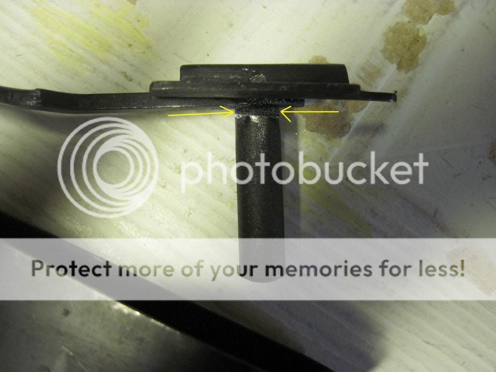

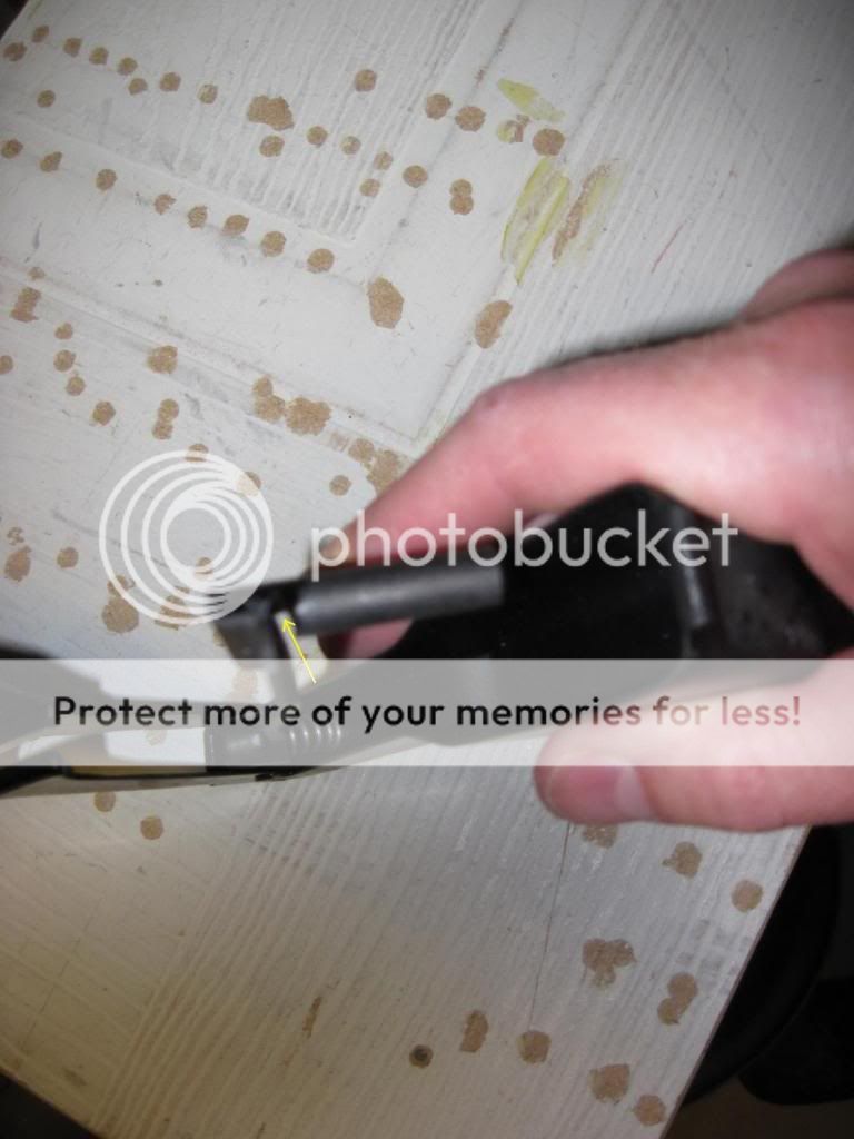

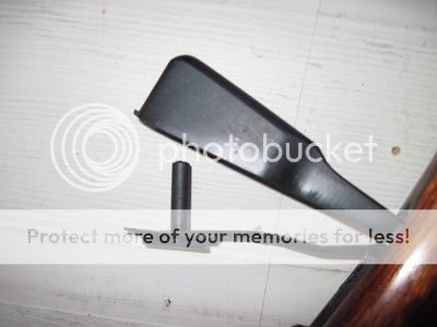

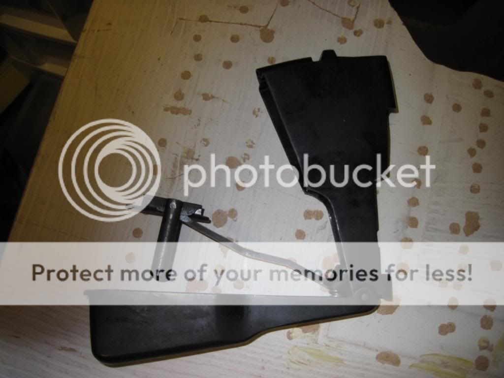

Here are some before and after pictures:
Magazine follower plate restricted by limiter cylinder - before adjustment.
Magazine follower plate no longer restricted by limiter cylinder - after adjustment.

To help address the issue, I soaked my magazine follower and plate for several hours in mineral spirits, and then applied several coats of WD-40 to the area. That loosened up the pin to allow very limited movement. Since the follower plate was only moving a little, I looked at it again and noticed that the limiting pin cylinder (5 shot limiter in Canada) was actually restricting the full movement of the follower plate.
I looked at it from all angles, and I realized that for my SKS I had to trim the top of the limiting cylinder that was restricting the free movement of the mag follower plate. Looking at the back of the limiting pin cylinder, I could tell where they cut a channel lower inside the cylinder from the top, but they did not remove the extra piece of metal off the cylinder to clear that area and allow the follower plate its full range of movement.
I took a thin manual metal saw, I used a spacer to make sure I wasn't cutting into the follower or plate, and then I simply sawed off the piece of the limiter cylinder that was blocking the plate. Once I removed that piece, the plate had greater movement, and I could see where the plate got stopped normally by the end of the follower bar.
