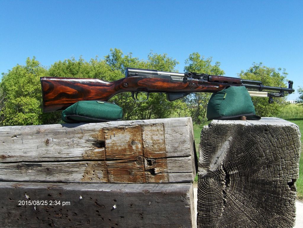

Love those 55/56 K letter laminates in red.
