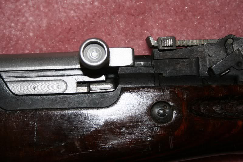

I've been playing around with A-Zoom snap caps and when I pull the bolt back and release it gently, it doesn't fully close and looks like this:
If I let it snap back, it fully closes normally but it gets stuck in really tight and requires lots and lots of muscle to pull to bolt back.
As for real ammo, it eats bullets fine I think. But if I let the bolt close really gently, it won't always close either. But snapping it back always seems to do the trick, but what if one day I load live ammo and gets loaded like first pic, what would happen to me or the SKS, more importantly, to ME! LOL!
As should be seen in both pictures, the bullet is 100% chambered, just the bolt not in full closed position. When there is no ammo used, bolt always closes no matter how gently I let it go.

LOL! So it's okay if for some reason bolt ends up like that in first pic?
I don't think it would ever get stuck like that under real world conditions, but I just want to make sure.
I do like snapping the bolt back hard, but resisted eventhough the firing pin is spring. Scared man, especially indoors and if it slam fires on me, cops will be at my door in no time and there goes everything I've worked hard for not to mention charges. Doh!
Try squeezing the trigger, with the dummy round chambered as per your picture. I believe the disconnector will not allow the trigger to move when the bolt carrier is not fully home. If the trigger can move when bolt carrier is not fully closed, there is something wrong with the rifle.
This disconnector is a safety feature.
Great idea! I just tried.
In that configuration as shown in the first pic, it can be fired. However, I tried again only this time purposely making bottom portion of bolt carrier not all the way in front (ie, actually able to visually see bullet is not fully chambered); it will not fire.

The rifle will not fire until the bolt is in full battery position, even half cocked like in the first pic. It is all ways recommended to let the bolt fly when chambering a round at the range.
When the bolt is not in full battery the hammer won't hit the fireing pin.
Take off the bolt cover, remove the spring and try it for your self to see what it does.
You will see that the hammer just runs into the bolt carrier.

My SKS has a spring loaded firing pin. Most of the parts were made in 1950. At least the barrel and bolt.
Hmm... I'll try out your test. In first pic, lower portion of bolt is completely forward, but the top portion is not. But I'll check it out and see what really goes on with the mechanics.
Definitely, I'll let the bolt fly back hard at the range. I'm just being a little scared being a noob and never fired anything this old or this calibre before. LOL!
The SKS 45 is a tough old bird, and as you have the spring loaded fireing pin you wont have any problems with slamfires.

You should be fine so long as you let the bolt run forward on its own and all rounds are fed from the magazine. This applies to any semiautomatic rifle. The bolt carrier on my SKS can hang up slightly on the receiver if you ease it forward, but it cannot fire if the carrier is far back enough to move the bolt out of battery.
