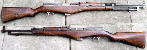

Im surprised how close the M1945 looked liked the SKS.

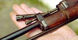

The gas chamber is screwed into the M1944 tide trunk serving forward emphasis for the handguard.

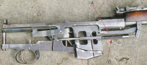

a - uncoupler; b - spring loaded reflector.
The arrow indicates the spring, under the action which is thrown pack.
When uncovered gate uncoupler not allows you to fully depress the trigger.

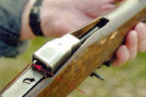

To extract the pack from the store to all cartridges are fired must click on the tab (arrow) ..

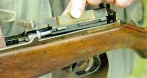

Receiver cover fixed projection rod return mechanism. Later it became part of the "corporate identity" Kalashnikovs.

Experienced self-loading rifle Kalashnikov design in 1945 is very different from the M1944. Outwardly, it resembles SCS, which is not surprising. The forty-fifth year of SCS entered Shchurovsky landfill, where at that time worked Kalashnikov, which took into account all the strengths and weaknesses of the current system and tried to beat her.

M1945. Right-side view.

The gas chamber is crimped onto the trunk. Handguard open at the bottom and allows (unlike SCS) to remove it without removing the piston. Changed the method of fixing and lining: spring replaced by contactor rotatable flag on the right side of the chassis rear sight.

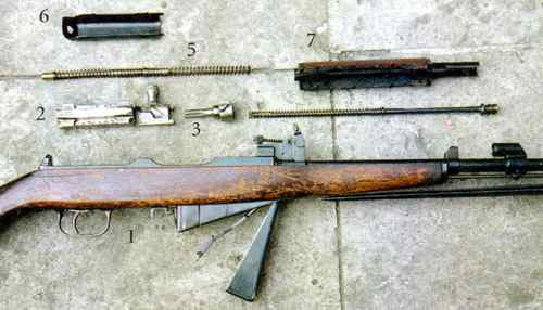

Details of the rifle M1945:
1 - receiver with the barrel: USM, a bayonet and a lodge;
2 - slide frame; 3 - gate;
4 - gas piston spring return;
5 - return mechanism;
6 - a cover of the receiver; 7 - handguard.
