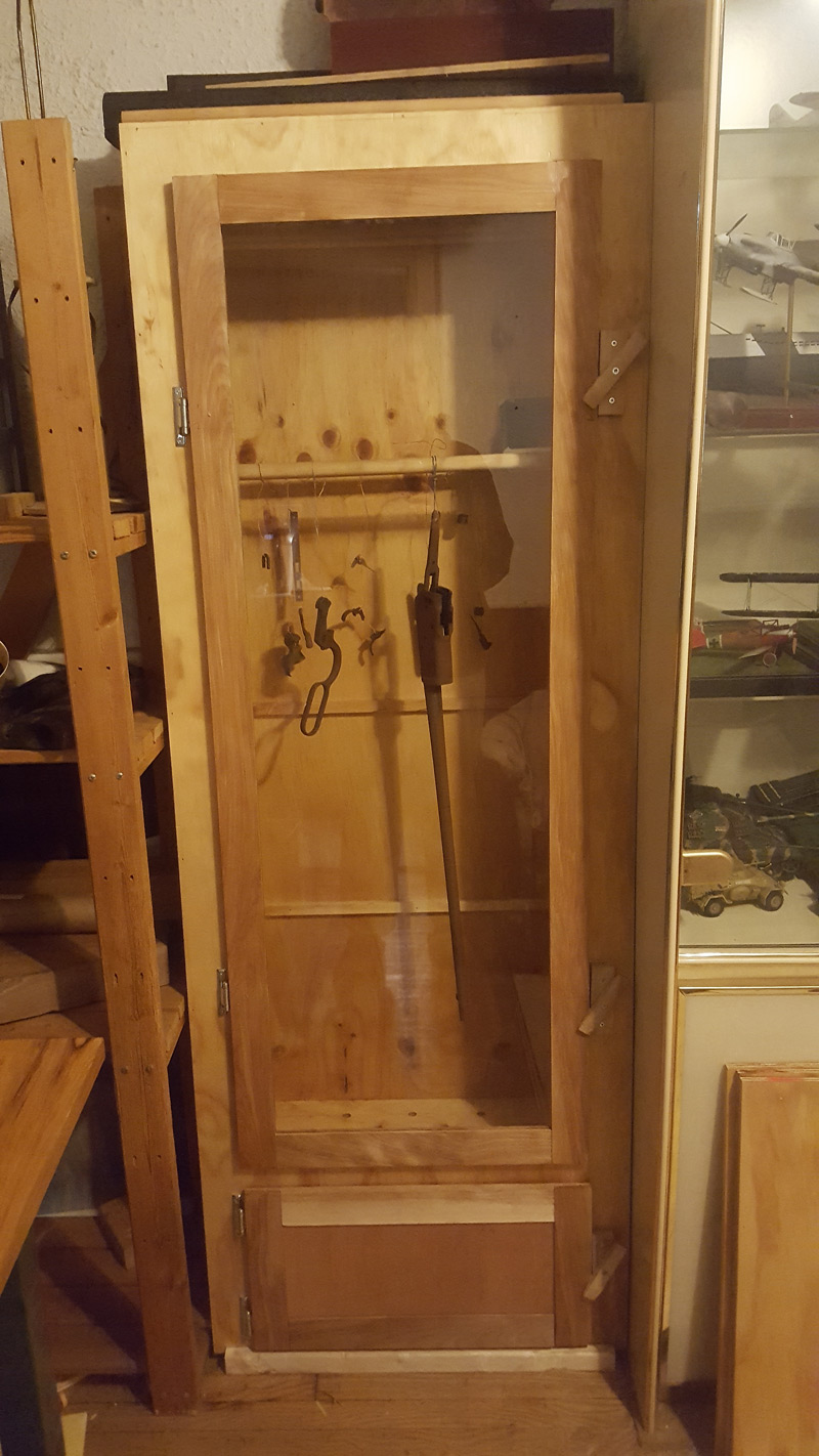

Here is what I built for my sweat box, there are shelves for it too, it doubles as a dry pantry when not full of gun parts.
All I do for browning is prep my parts, wipe with my own solution hang them in the box then pour a pot of boiling water into a pan/jar/beaker/whatever-is-convenient in the bottom of the box. Then seal it up (3 coats of spar varnish and weather stripping - it is pretty much air tight)
The water keeps the temperature and moisture up for a good 12 hours....!
I also use a steam generator (for wood bending - great little unit!!) and 4" ABS tubing to steam parts .... what I can say about that is be real careful, you can get too hot VERY quickly!
