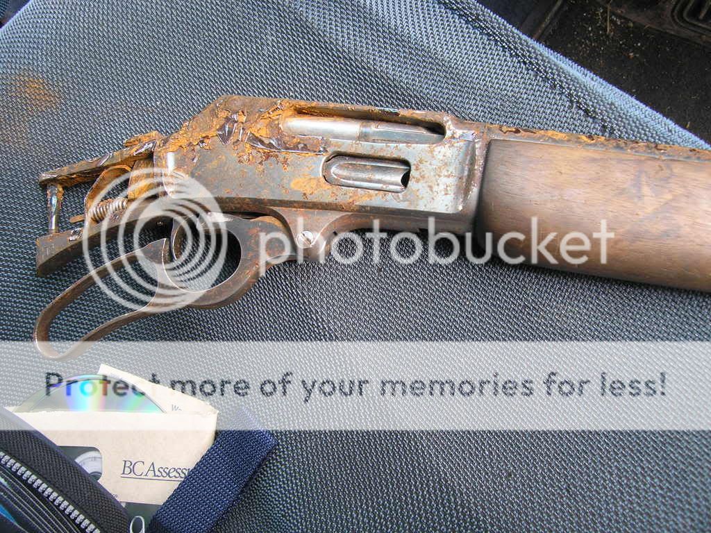

I was given this Sears model 45 in July
Been working at it for month
Polished it up on Saturday
Cold blued it yesterday
Now I'm waiting for a butt stock to arrive

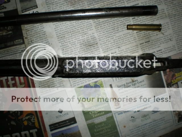

Some pitting in the bore, but most of it shined up pretty good.
used ATF works good for freeing rusted parts let it sit in the oil for a day or two and it will free up but i would never use it i have seen guns blow and its nothing i would want to go through but it would look nice as a display gun
That flat side could be a great training ground for a draw file. You could make that flat sharp and clean pretty easy. The mag tube and barrel also look like a patient man who took his time could restore.

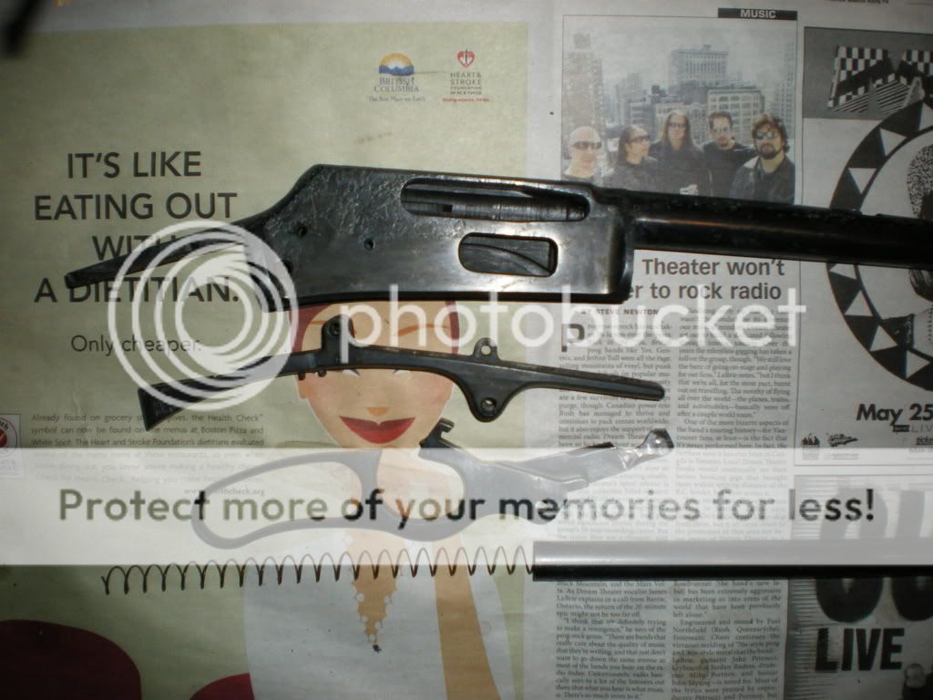

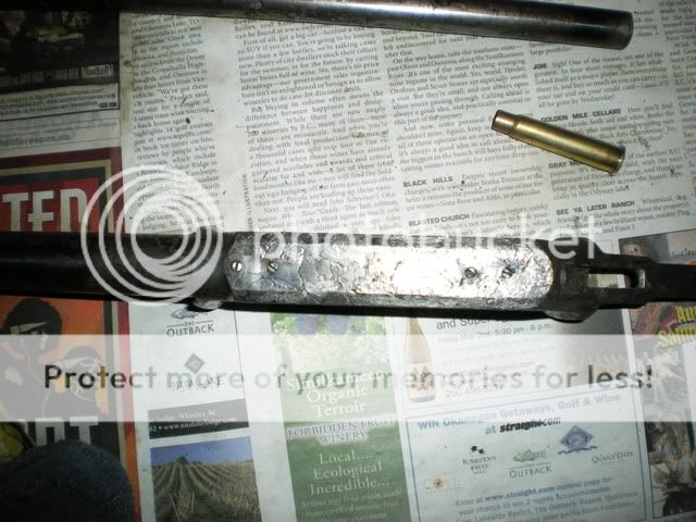

The top of the receiver was pitted the worst of all.
It took a while just to get a crust of loose rust and even some spilled epoxy paint or something off, then it looked like this.

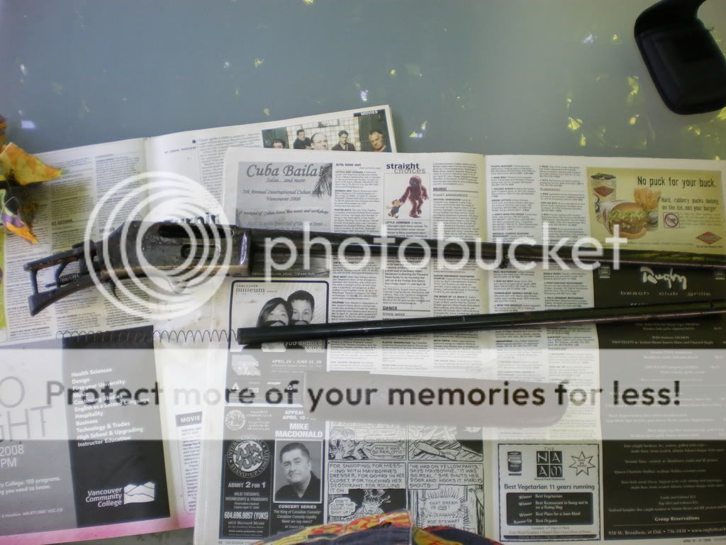

I neglected to take further pictures, but when I finally exposed the screws and soaked each one with Fluid Film enough, they came out and yes, I did some draw-filing there.
I'll be covering that up with a one piece scope mount anyway.
All the internal receiver parts are in remarkably good condition.
Another skill you might teach your self is barrel lapping with a lead lap and rouge.
I would encourage you to remove the remaining pits on the external frame. It will acutally make it stronger as you will be removing all those stress risers. Better to have less smooth metal then more pittied metal. You might also find that unless you really chemically cleaned those pitts well they never stop rusting despite the blueing.

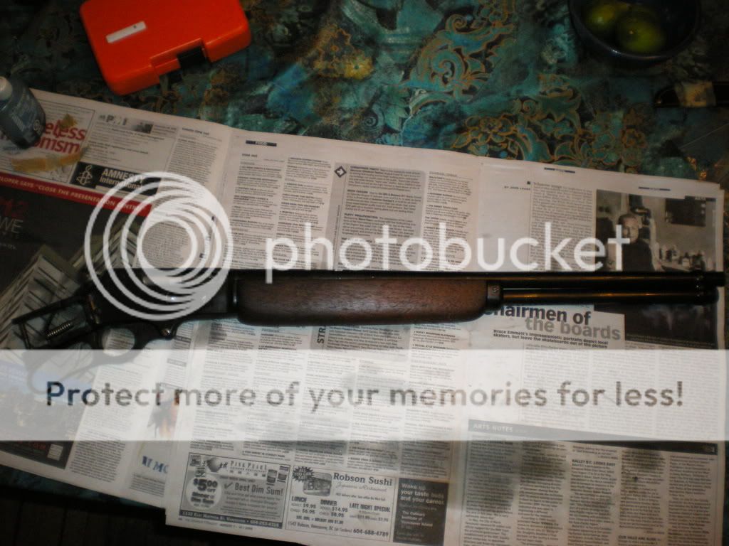

Remember, it looked like this:

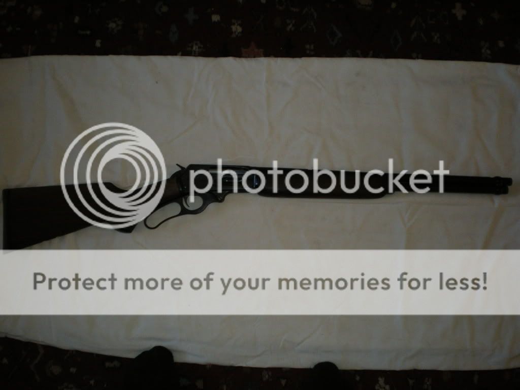

I assembled it yesterday and it now looks like this:
According to Canada Post, my butt stock was at the Richmond sorting centre yesterday.
If I get the stock today I'm going to Reliable for a scope base this afternoon.
