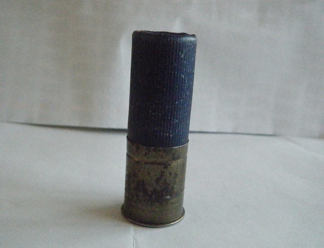

Last Winter, I found a box of Imperial high-brass #4's that had gone un-noticed in the cellar since 1984. The brass was discolored, and looked kinda sketchy...but, I cleaned 'em off as much as I could with some emery cloth and went out to the Range. They fired perfectly - pretty stiff to extract from my pump gun, but perfect in my SxS.
I kept this one, unfired, just for old times' sake:
Go ahead and have some fun with those 16's......:D
