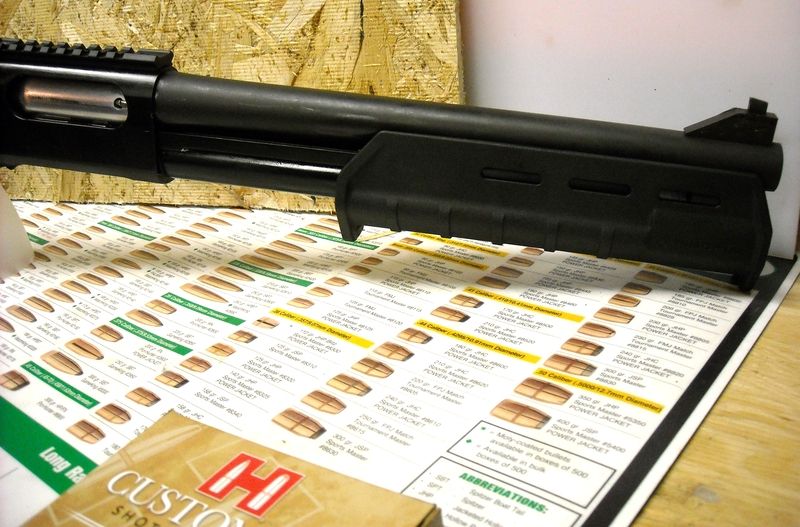

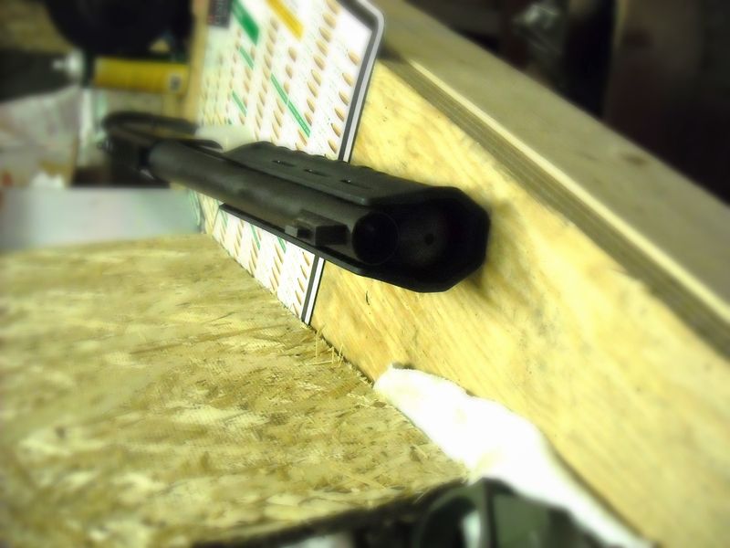

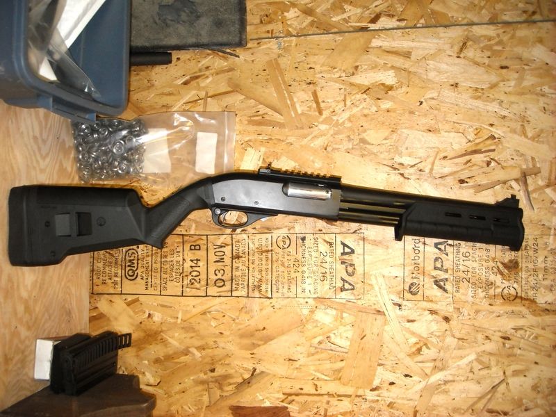

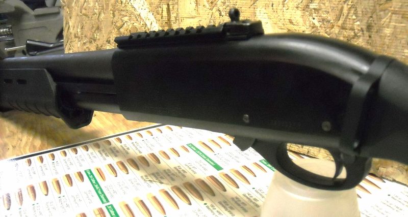

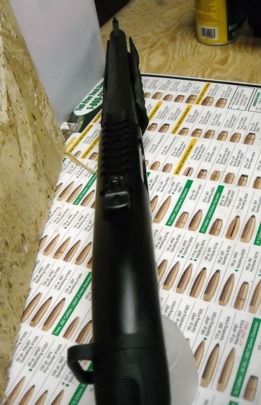

S&J 870 custom 12.5 inch bbl
This gun will be completed by next week
What it is.
Remington 870 express 3 inch magnum
12.5 inch bbl 3 inch magnum screw in choke tube
Work completed
Stripped complete frame, sanded polished and bead blastedouter frame till all imperfections were removed
Polished internal rail guide slots until smooth.
Rounded out ejection port, removed machining marks and burs
Drilled and taped and installed XS M1913 rail and adjustableghost ring sight
Stripped, polished and bead blasted barrel.Cleaned up and trued choke tube threads
3 stage polished chamber and bore with 12 gas polishinghone, med, fine and extra fine
Adjusted and polished and trued ejector slot on barrel
Polished and debured pump for end metalPolished bolt carried and bolt, firing pin and extractorslot.
Trigger job nice and light and smooth much less creep.
Full Cera Kote Matte Black finish.
Parts
Wingmaster chrome bolt and bolt carrier
S&J no jam follower and 600,000 cycle long like magspring.
S&J jumbo safety
S&J RH single point sling mount
New Remington end cap
Mag pul stock set
This is one smooth fast firing 870 custom shot gun$899.99 + tax and shipping ( ins is an option)
