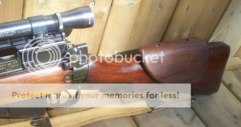

B Square are pretty good. Very lightly built though and made in China as I recall. I had to change out all of the fasteners they included. You can use a Mk II flip sight with it.

Currently , I'm using a B-Square on a No4 ( aluminum ). They need some very simple tweeking but mine has held on thru countless shots.
Now , with that said , if I where to purchase another I'd take Cantoms' lead
