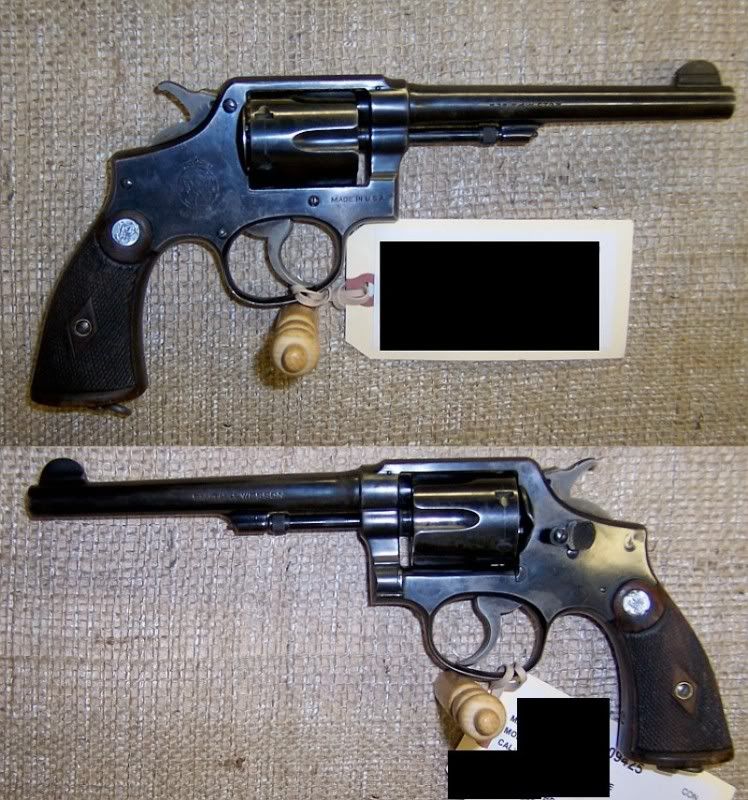

I would say that there is little doubt that what you have is one of the many S&W revolvers acquired by Britain during WWII (officially designated "Smith & Wesson Pistol No. 2") for issue as "substitute standard" in lieu of the official British handgun at that time, namely the Enfield "Pistol, Revolver, No. 2", chambered for the British service cartridge originally referred to as the .380-200.

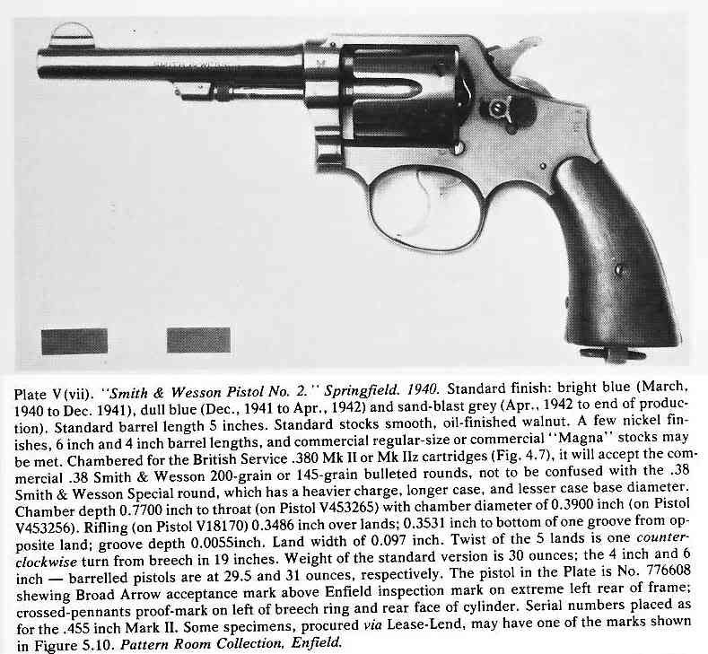

FWIW, here is an image and caption scanned from Chamberlain & Taylerson's
"Revolvers of the British Services, 1854-1954" -
