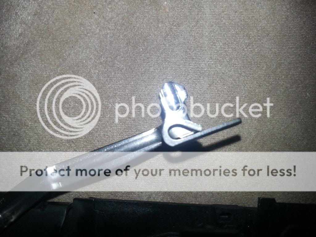

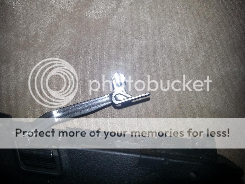

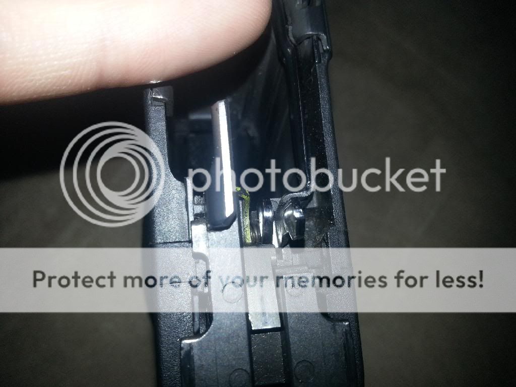

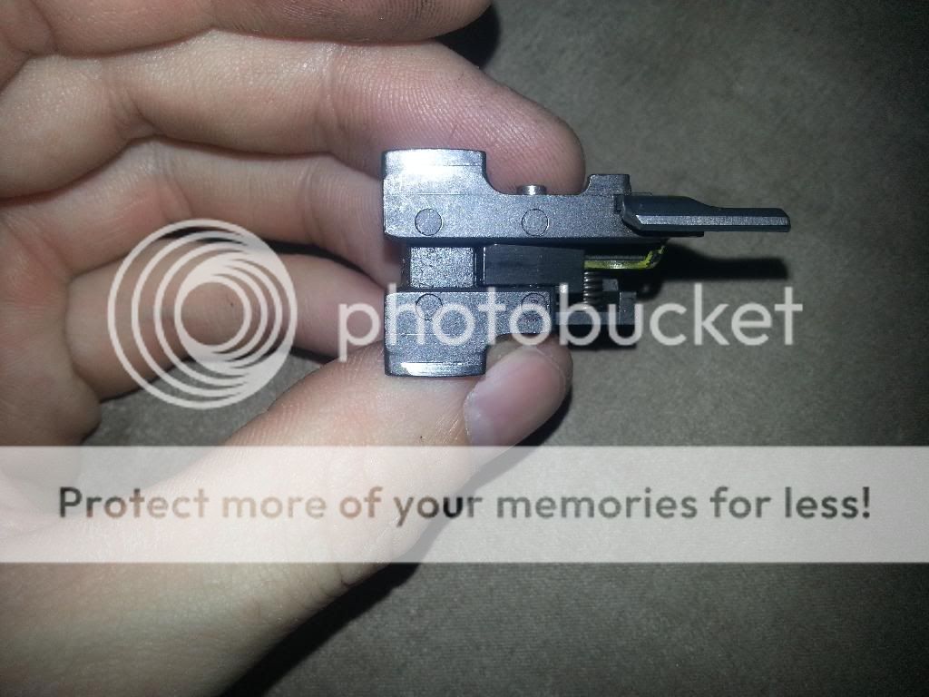

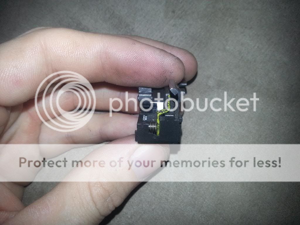

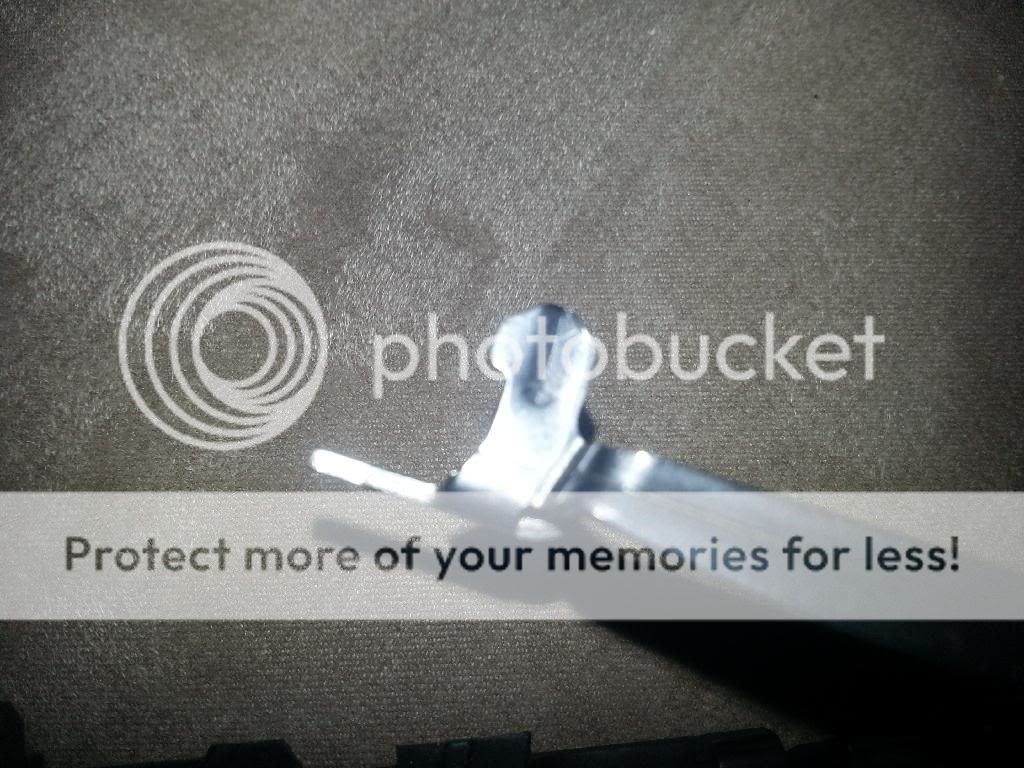

either your not letting off the trigger enough for reset at that time, or the slide it partially out of battery so the sear is not getting tripped.
Try letting the trigger out all the way for each shot - see of there's an issue. If not, then there's a false reset (assuming the slide is in battery) you can smooth this out by polishing the FPB and the FPB extension on the trigger bar. You can accentuate the genuine reset by very gently (VERY gently) flexing the trigger bar toward the center line of the pistol.
I kept doing the same thing with my trigger because I wanted to test one solution at a time to see what the problem was. I flexed the trigger bar in a bit and it happened 0/100 rounds. It seems like it worked. Also my reset feels even more apparent now, does that make sense or is that just in my head?

I was letting the trigger reset all the way. The trigger bar was the issue, but flexing it in towards the center line of the pistol 2mm was all it needed. I don't need a new trigger bar. Over 500 rounds now with no issues since the "fix"
Good to hear it. Reference the "American Engineering" the trigger bars are stamped steal and not the most consistent. SW also has loose tolerances so from one gun to the next there may be similar problems caused by different issues. I hope she runs smooth for you now. When the MP trigger is pulled fully to te rear the trigger bar does flex a little. Over time this may undue your tweak and you may need to do it again. Randy at Apex says he's working on a new trigger bar that will eliminate any of the issues that have happened over the past few years.

Now over 2500 rounds fired since the fix and not one mishap. Flexing the trigger bar in 2mm was absolutely all it needed.
Thanks enefgee I believe you suggested I tweak the trigger bar towards the center line of the pistol. Worked like a charm
