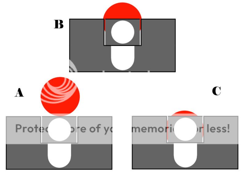

whats your sight picture? A,B,or C? My M&P 9 shoots type C (115gr @ 20yd)...this may explain why you are shooting low if you are expecting to shoot type A or B.
