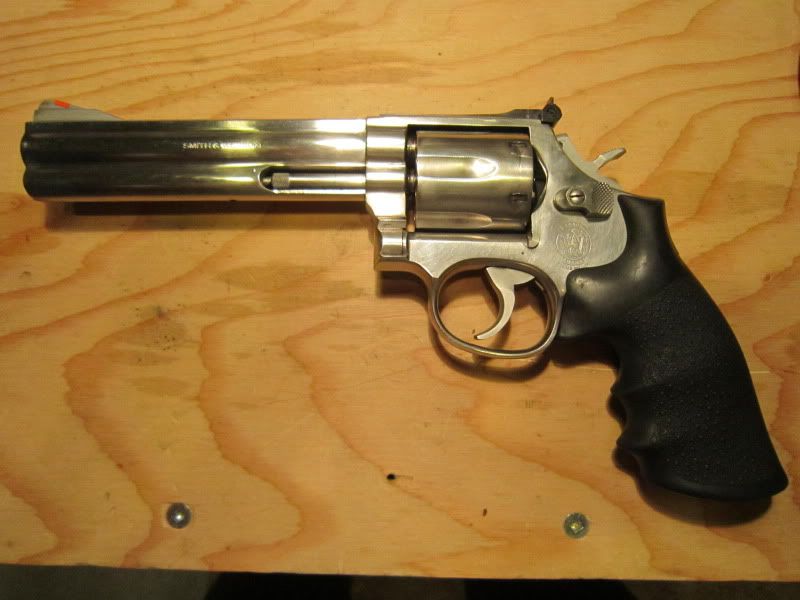

I'm planning on cutting my trusty 6'' 686 down to 4.2'' and am thinking about modifying the frame to a round butt configuration. Does anyone here have any experience with this? I picked it up used at WSS Calgary about 13 years ago and don't have much invested so I'm not worried about devalueing a classic, these things are everywhere. I've seen photos of a short stainless 686 with a nice wood round butt handle and would like to convert this one rather than trying to find exactly what I want. AFAIK S&W doesn't even sell a 'Canada legal 4 inch' like the current run of Ruger GP100's.
Any help would be appreciated. Thanks.
