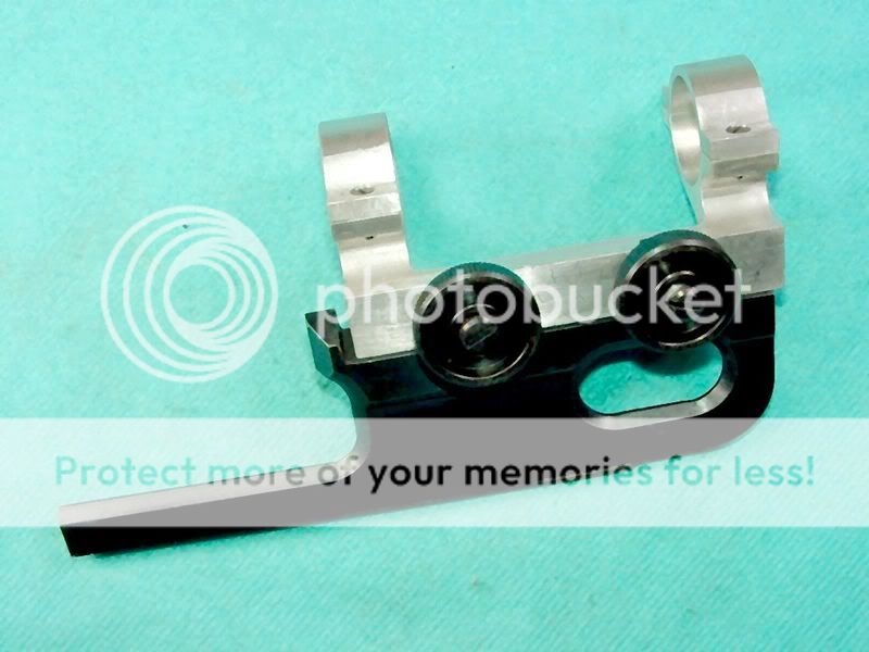

This gent lives in France & is the one i got off him some time ago very nice mount mine is stamped with a 7 so was a good match for my Veny 7mm rifle it is a buy it now post and is $195.00US if your looking for one this is it i received mine from him in 5-7 days from France no problems.

I have an Argentine FN49 and would like to buy this mount. Can you explain how it attaches to the receiver and if any modifications have to be made to the gun and of what material is it made?
I would love to have a scope mounted in this gun since it is very accurate just with its open sights, but wouldn't want to alter it in any way.

I have this mount for the Venezuelan (got it from this guy in France 2yrs ago) and will be putting the rifle and mount on the EE shortly.
If someone wants to buy the mount separately I can do that.
As far as I know it only fits the Venezuelans or an FN-49 sniper.
You have to have the dove tail machined into the left side of the receiver [ factory machined ] the Venezuelan, 30-06, and some 8mm Egyptian rifles have it only or your drilling and tapping not something I would do even more so on yours not to many out there if yours is the 7.62 model [ converted from 7.65 ]

Thanks Maxinumarmor for the info. My Fn 49 seems to have a dovetail lenghtwise in the left side of the receiver. It is very shallow but I think it might be able to hold that mount.

You got yourself a real rare rife there if it has the dove tail cut into it I never heard of the 7.62 conversions coming with it hang on to it you have the best of the best there adding the scope mount will top it off.

The FN 49 in 7,62mm is the one that I have here in Canada and although the wood is not so nice, the gun seemed to have been shot very little. I will get some pictures and post them for you too see. Maybe what seems to me like a shallow dovetail is not what you are talking about, either way I will like to know for sure before I fork out a couple of hundred bucks in the base.
This is my Argentine FN 49:

It looks like you don't have the dove tail it would be cut in right where the name is on the left side and that name would be on the right side your only choice would be a mount that replaces the dust cover/back site or you would have to drill and tap the left flat where the name is.
Your rifle looks fine remember they were well used before they hit the surplus market.There was very few also converted.

Thank you Maxinumarmor for your help, I was about to buy the base thinking that it would fit in that lengthwise slot on the left side of the receiver. I guess I will leave it as it is.
