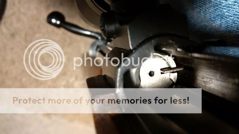

Whoever decided that the ejector should be positioned at the 6 O'clock position needs a kick in the head. Honestly, if you want to throw something out the window you direct it toward the window.

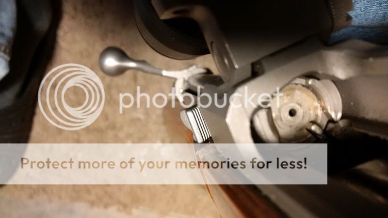

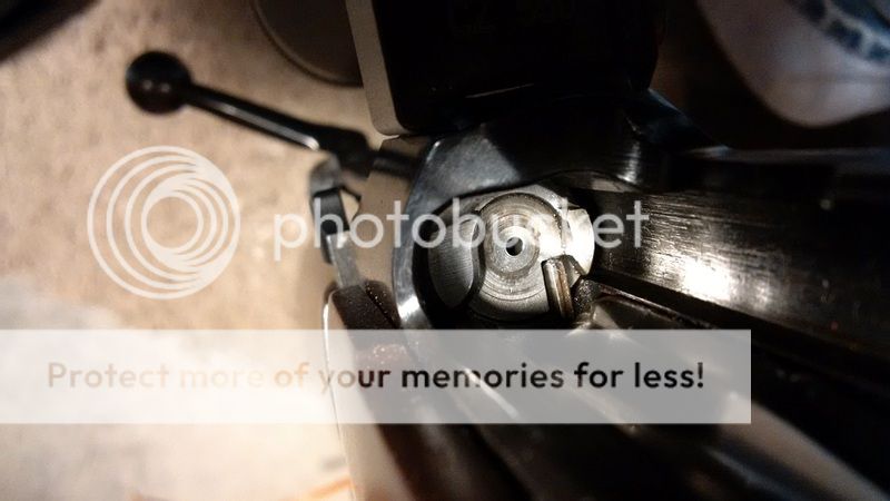

A rather curious design. Small windage turrets don't seem to interfere with ejection. Sako 85, CZ550, Zastava and Ruger Hawkeye designs for comparison -
Sako 85
CZ550
Zastava LKM70
Ruger Hawkeye
