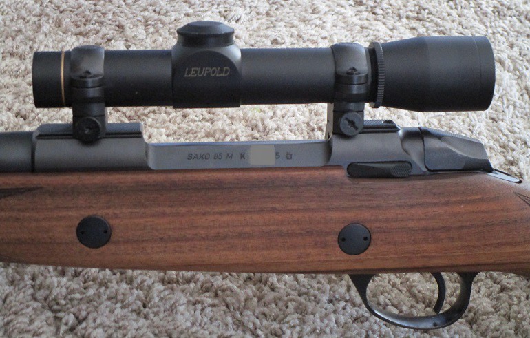

The Leopold ring mounts didn't work well with my vx5 setup.
I don't know if it's machine that way or what but the Leupold 30mm ring mounts actually don't Tighten up on the Front ring Mount until almost halfway down the dovetail. I tried another set and it did the same thing and I've tried it on multiple firearms and it does the same thing so because of this it doesn't work for me
That’s correct, they say in the instructions to center the front ring. Same with the Sako ringmounts - they may be able to grab further back, but they are made to clamp in the center of the front dovetail. The only 1-piece mount I know of that was made differently was Warne premier series (my favourite Sako mount). They were made to grab the back of the front dovetail, and the front of the rear dovetail. They were also vertically split so moving them forward or backward did not affect the windage adjustment, or scope tube alignment unlike most other designs. The Sako ringmounts added the spherical bushings to eliminate the scope tube alignment issue, but changing the postion will alter your windage adjustment.
You can still find the odd set of Warne maximas for sako’s, but they were made of sintered steel which wasn’t near as strong or ###y as the original machined premier series. I wish someone would bring the Warne premier style back.... :(
Right, as noted in the instructions the front Leupold Ring Mount can't be positioned more than half-way back on the front dovetail or it can't be tightened to grip. Bummer if your scope needs the front ring set back further on the dovetail.
