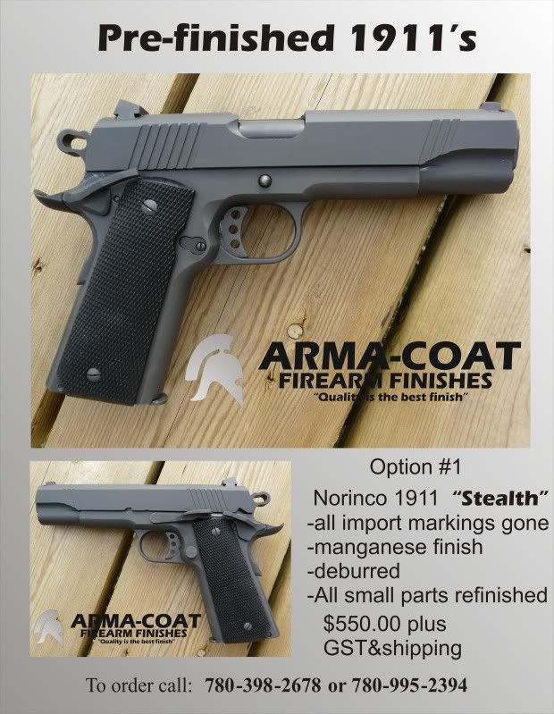

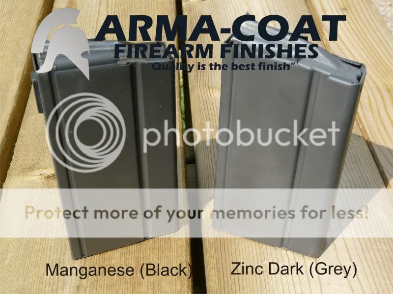

80 grit aluminum oxide is what we use in the shop. You will need the steel to be clean and have an even porous finish to get the best results. Here is a few pics of the end result.
