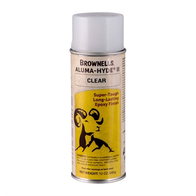

Matte Clear ALUMA-HYDE® II
They can't ship it to Canada, they say. You might have to go to the U.S. to get it.
I tried this one (the dark grey color) about 2 years ago. It couldn't stay on under Birchwood Casey Gun Blaster/Degreaser and came off. So it was much weaker than Duracoat.
Not sure whether its formula has changed since then, though.
