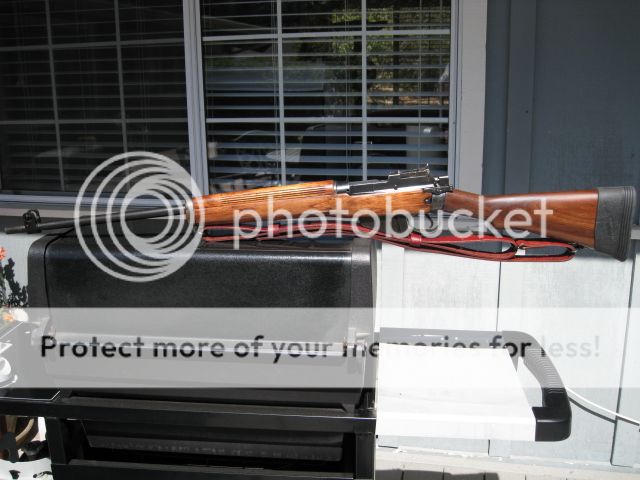

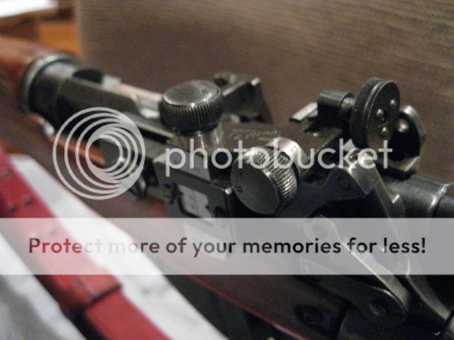

Here are some quick photos of the rifle in question. It seems to be in really nice shape.

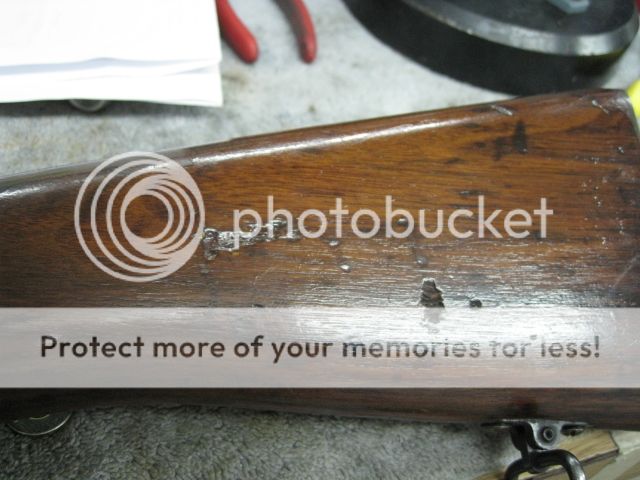

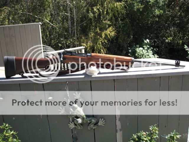

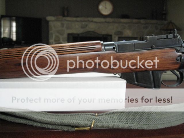

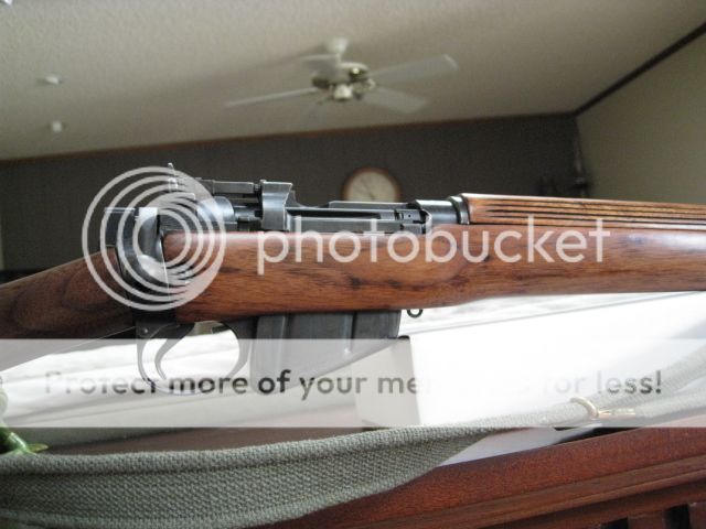

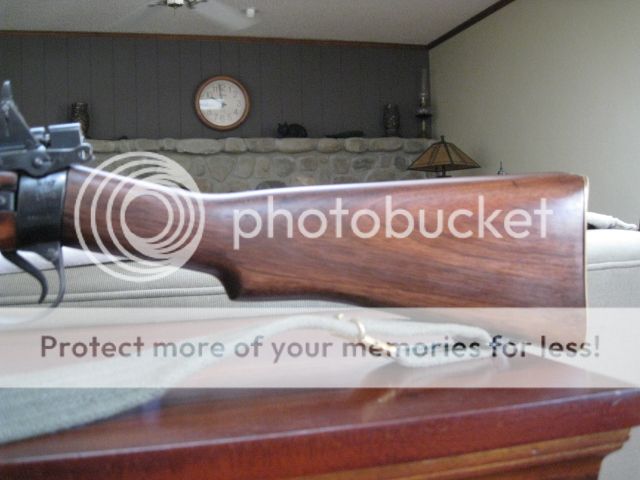

If you want to do something to your gun why not refinish the Wood, and by that I mean a proper Oil Finish that will make the grain really pop.
Above is a pic of mine before, and the wood was atrocious. It had a 1/4" thick layer of varnish on it and I literally Scraped it off with my pocket knife! I then went after it with a finish sander and 60 grit paper until I was under all the gouges and into good solid wood. I had 3 different colors of wood to try to match and I got two of them close. The buttstock was much darker and that's where it remains.
You will be amazed at how much character there is hidden in the grain.
They really come alive in the direct sunlight!
Good luck and you've got a decent one to start out with.
