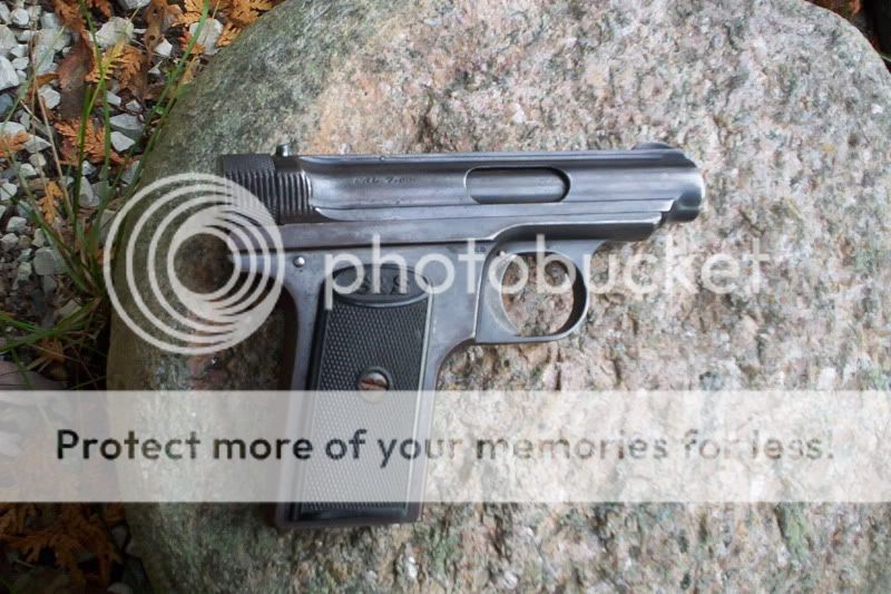

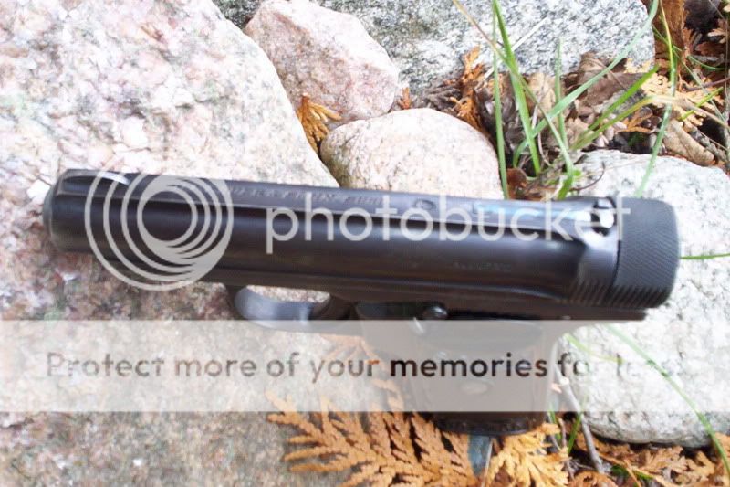

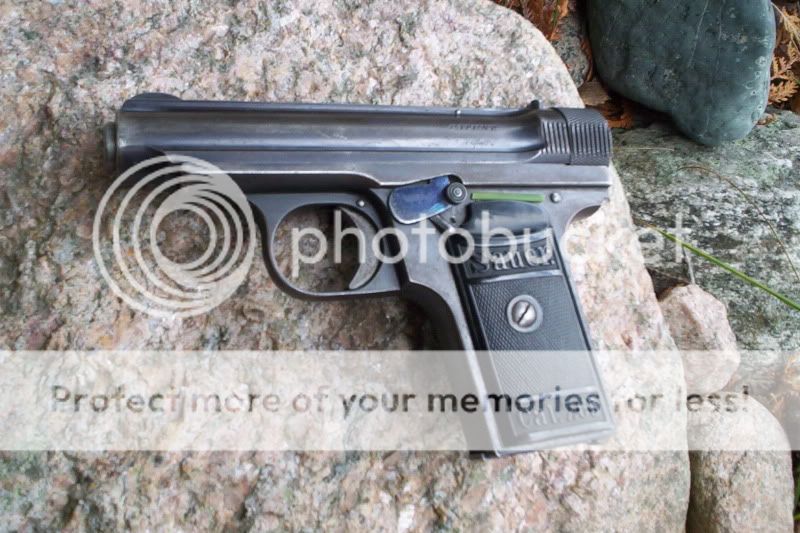

Not much into handguns , so I am just wondering what info is there on this piece ?
Story behind it is, it was taken from a badly wounded Nazi officer ( somewhere in France ) and shipped back to Canada via a nurse heading home.

Yours could either be a Sauer 1913 of varying models, a 1919, a 1926, a 1930 or a Sauer Behördenmodell... ;)
That is a cool little pistol you have. More than likely used by rear echelon forces such as Railway, Treasury, etc.. personnel,

Ah, a very sweet 1913 J. P. Sauer & Sohne. They were in 7.65, of course, and had a baby brother, same design just scaled down completely, every part, in 6.35mm.

The guns are all-machined and they are a pretty good design. They do have their quirks, such as the reversed position on the safety..... and the rear sight being made out of a single spring so it could also be used to lock the action together, thus avoiding the embarassment of having your gun field-strip itself when you want to use it. The magazine catch also works reversed from normal practice. Stripping is by pushing down on the rear sight and unscrewing the cocking-piece, which is also the action plug and tensions the recoil spring. The actual breech-block is a separate machined piece.
They are solid and well thought-out. CAREFUL with the grips!!! They come off like TT-33 grips! They are also thin, fragile after this many years (gutta-percha hardens over a century) and can be broken easily. Repros ARE available, but originals are much nicer.
These, and their later descendants, the 1938, were great favourites as pocket-pistols with German officers and with all ranks of the Waffen-SS. The tale which comes with your gun is entirely possible and would rank as one of the more unremarkable capture stories..... and that, alone, gives it much more currency than some of the hair-raising tales which are circulating.

Forgot to mention, grips on yours are a later pattern than on mine. Mine have the grips in 3 panels with the checkered portion in the middle with a top and botom border, "Sauer." above the checkered portion in its own panel, "Cal. 7.65" in a separate panel below.

Thinking (I do that from time to time, although you'd never know it) about our toys. I think yours is somewhat later than mine (they were made well into the 1930s). Mine is the earliest type.
On the early type, the triggerguard is ROUND and the trigger is 2 separate parts, joined together and working together. If you have an empty gun, you can drop the mag and fill it, press with your trigger finger UP against the trigger extension and rack the slide: you now have an action hold-open. If you insert the magazine with the gun in this condition, a single pull on the trigger will chamber a round and a subsequent pull will fire the piece. You can go from "Empty Gun" to "Loaded" AND A ROUND FIRED in less than 1 second.
Just something to watch for when handling the early guns.
I don't know how many of these early features your gun actually has. BTW, both grips on my gun are the same as your left grip.
