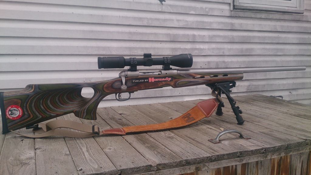

what ^^^^^ said. The biggest factor in availability and choices of stock on savages now is the location of the bolt release. Quite a lot of choices for side of the receiver bolt release, not as many choices for the newer front of trigger guard bolt release.
Boyd's are good stuff. I put one on my Savage 16 ITH and it really improved the groups.
