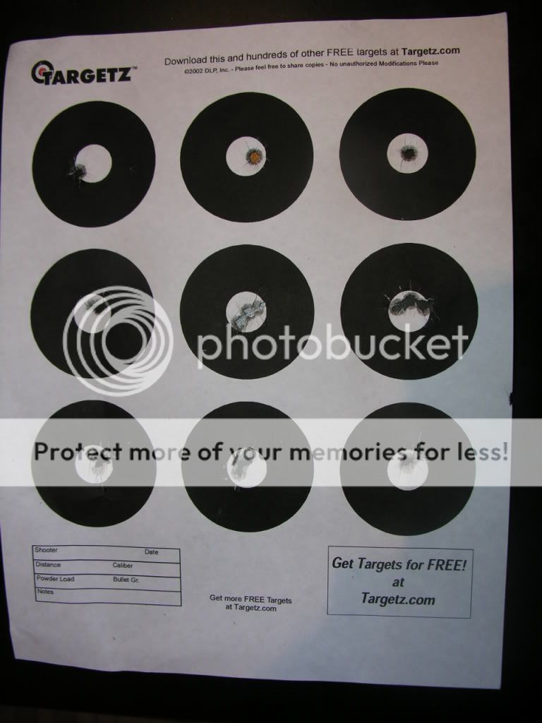

Today I began trying different loads to see what it liked best using the same Varget, 175gr SMK's in Hornady brass and CCI 200 Large Rifle Primers.
I loaded up the rounds as indicated below:
.308 Winchester 180gr SMK 41.7gr max load 2.800” OAL
1) -10% = 37.5gr 1 Round
2) +2% = 38.3gr 1 Round
3) +2% = 39.0gr 1 Round
4) +2% = 39.8gr 3 Rounds
5) +1% = 40.2gr 3 Rounds
6) +1% = 40.6gr 3 Rounds
7) +1% = 41.0gr 3 Rounds
8) +1% = 41.4gr 3 Rounds
9) +1% = 41.7gr 3 Rounds
The first 3 shots were used to fine tune the scope and foul the barrel and the rest were shot in a round robin format with 1 shot at target #3 then one at #4 and so forth till there were (6) 3 shot groups.
This is the result.
This is the result.
